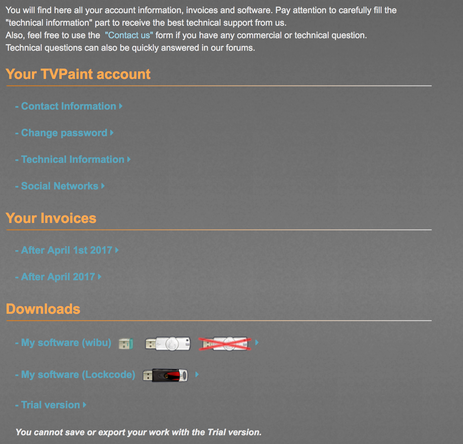

JeremyN
Posts: 365
Joined: 24 Apr 2015, 14:41
Re: TVPaint 11.5 crashes if I use the new fullscreen shortcut
Post by JeremyN »
Hi,
Once you are on your account page, in the "Downloads section", you should have "trial version" just under "My Software (Lockcode).
You can also access this page by clicking "Trial version" on the left of the screen.
If not, let us know.
Mac Developer
schwarzgrau
Posts: 1238
Joined: 23 Jan 2012, 22:08
Location: Offenbach / Germany
Post by schwarzgrau »
Thank you Jeremy.
The shortcut works in the Trial.
Windows 11 22H2 / TVP 11.7.0 PRO WIBU / Cintiq 22HD
Windows 11 22H2 / TVP 11.7.0 PRO WIBU / Mobile Studio Pro 16" (2019)
