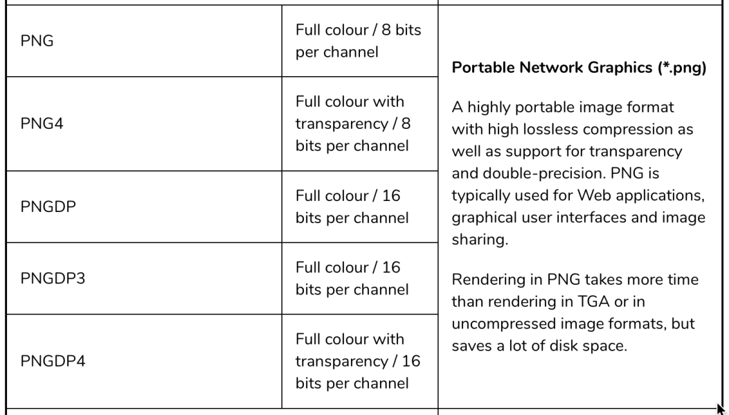

Re: 10bit or more support in TVPaint? Anytime soon?
It seems like Harmony can export in 16 but I guess that is based on an animation made in vector.
https://docs.toonboom.com/help/harmony- ... rmats.html

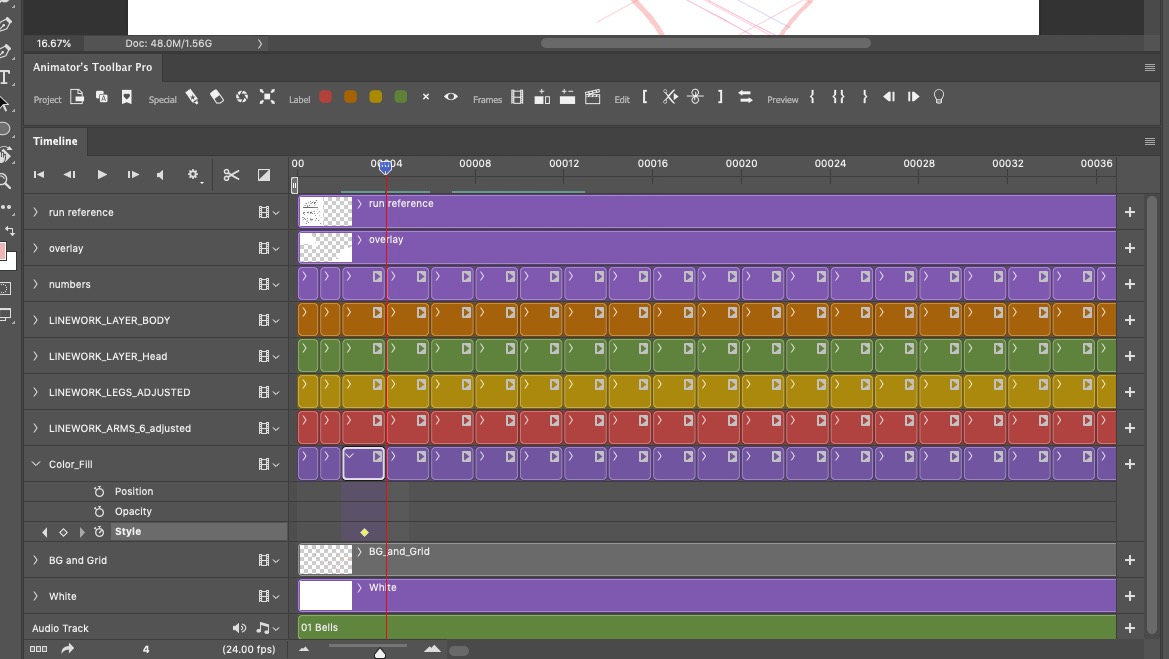

While it is not ideal for creating hand drawn animation compared to something like TVPaint, there is also Adobe Photoshop (which has options of 8bit, 16bit , 32bit color mode). Using a plug-in like The Animator's Tool Bar Pro makes the animation timeline in Photoshop more manageable , although still not ideal ; it's a very tedious experience, compared to the ease-of-use we enjoy in TVPaint. I would not recommend Photoshop for animating , unless you had no other choice , in which case The Animators Tool Bar Pro plug-in makes it at least tolerable for animating. However, for those who need the color to be rendered in 16bit mode it is an option to bring in line art layers from TVPaint (as transparent PNG image sequences), then color in Photoshop in 16bit color mode. It's not that difficult if the animation is all ON 1's or all ON 2's with no holds , no repeats, and no layers that have staggered exposure... if every layer has the exact same timing and lines up from start to finish on the timeline , it's not too time consuming to load the PNG image sequences into PS. Where it becomes tedious is if the layers are not all exactly the same , with the animation exposures varying between 1's , 2's , or holds , or if you have repeated cycle animation which then transitions back into new animation, then back to the repeated cycles. In those cases you must manually reconstruct the original timing on the Photoshop Timeline. It's a big headache.
If there were an export/import script (similar to the AE script) which allows for scenes to be exported from TVPaint and then imported into Photoshop with the layer structure intact , it would make this workaround (to gain 16bit color depth) more of a streamlined process. I don't know if such a script could be created. I realize that it may be possible to do basic flood-fill coloring of line art imported into AE (?), although that's not something I've ever tried, so I don't know how it works. I've been intending on running a short test to see how it would work to import a scene from TVPaint to flood fill color in AE. I'm just more familiar with using the fill color tools in Photoshop or Harmony. (coloring in Harmony is very efficient and automated ... with Photoshop you can create Actions to automate some coloring functions)
(animation timeline in PS, with Animator's Tool Bar Pro plug-in)
Just to be clear, I'm not in any way eager to abandon TVPaint for Harmony (even less for Photoshop) for animation or coloring. But I don't think it helps to ignore the issues which Peteris Sudakovs mentions in his post above. If you have clients who need 16 bit color , some sort of workaround pipeline to get artwork from TVPaint to Harmony (or Photoshop) to color it and output it in 16bit color mode is vitally important, until the next gen TVPaint is available. This is also not a new discussion ... going back five or six years on this forum you can find discussion regarding the limits of 8 bit color mode. (mostly in relation to difficulties with gradients and transparent effects).
