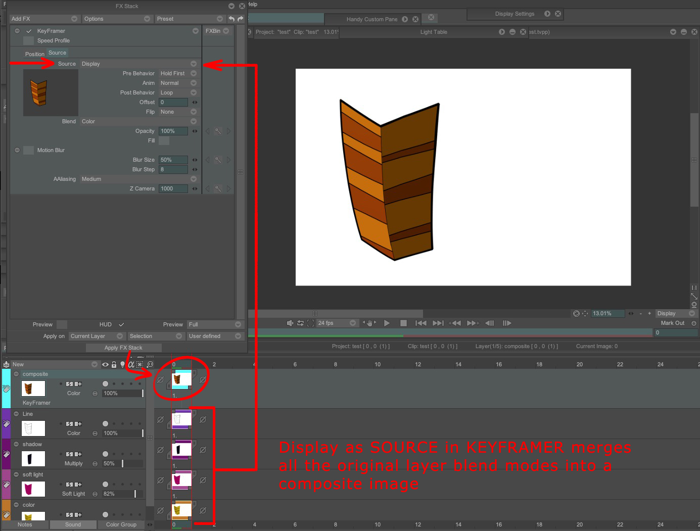

And now I see another way of merging a composite image with the blend modes intact: Use the *KeyFramer , with source set to DISPLAY.
(*Sadly, this method of compositing with the KeyFramer does not work if the source images do not include at least one layer (on the bottom layer under the blend mode layers) which is a normal Color blend mode image. If the images are only in blend modes such as Multiply they do not appear in the KeyFramer . See this topic for more discussion of the issue: https://www.tvpaint.com/forum/viewtopic ... 21&t=13271 )
