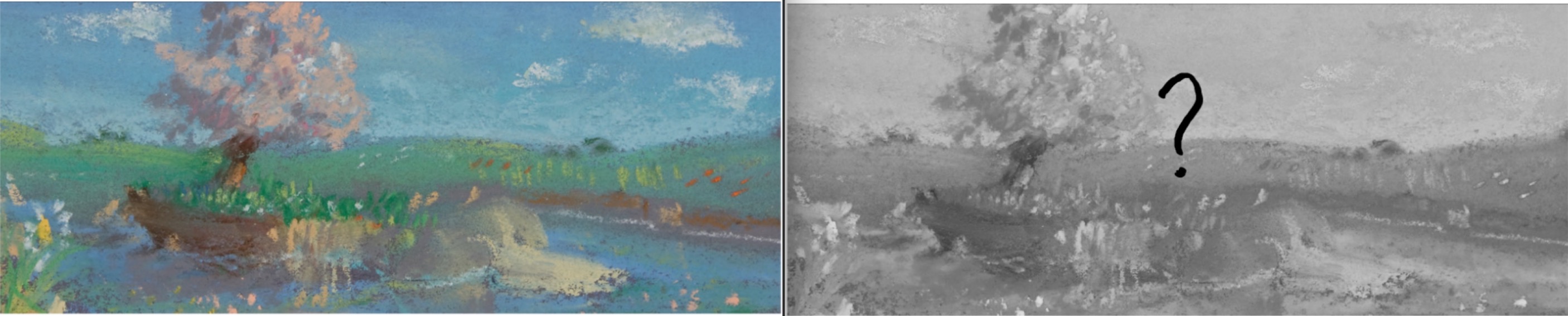

Animationriver wrote: 26 Feb 2021, 17:45 Unfortunately your script changes the color depth.
Hi, AnimationRiver -
From the examples you posted , it seems like the image converted with Svengali's script loses contrast . (it appears a bit "flat") compared to the image converted using the Scan Cleaner.
Perhaps the parameters of the script could be tweaked so it does not reduce the contrast on the resulting black and white image ? Or maybe the script can be changed to apply Scan Cleaner rather than changing the merged layer's blend mode to VALUE ?

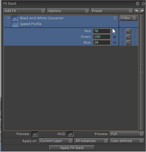

OK, here is another option for tuning the B&W conversion, but YOU have to do some of the work.
Load the Black And White Converter found in the color FX.
load one of your images and tune the contrast values for Red, Green and Blue to your liking.
1. Be sure the box for Black And White Converter is checked.
2. Be sure that "All Instances" is selected.
EXPORT the FX to your GEORGE folder under the name "BlackAndWhiteconverter.bin"
Black and White Converter FX2.png (27.85 KiB) Viewed 22900 times
Now, as before, select the script below and insert it into your button as an Embedded Script.
When you run this script version it should render your images in B&W EXACTLY as adjusted by you.

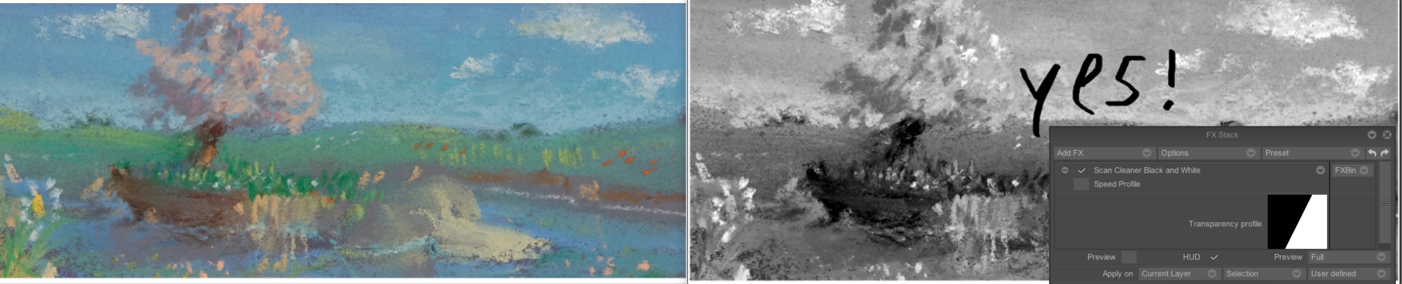

For instance, you could try substituting the Scan Cleaner Black and White...

Aside from a script, I was wondering if this procedure would work for your purposes:
1.) You need to convert multiple (100 or more) color images to black and white , each image in a separate Clip. If you had all the color images to be converted in a folder , could you use a batch
renaming app to automatically give all the image files a consistent naming convention , such as COLOR_IMAGE_0001, COLOR_IMAGE_0002 , COLOR_IMAGE_0003 , COLOR_IMAGE_0004, etc. , (I use ReNamer , a batch file renaming app for macOS that allows you to rename lots of files quickly and conveniently. But if you are on Windows I think there are similar apps for Windows.)
2.) Then import all images into TVPaint. If the images have a consistent naming convention they should all import to a single layer in the Timeline.
3.) Now select all the color images on the Timeline and use your keyboard shortcut to apply Scan Cleaner B&W .
4.) Next, use a keyboard shortcut for Split Clip and advance from one image to the next , each time clicking the keyboard shortcut for Split Clip. Although this is somewhat repetitious , it should not take too long to split 100 or more images into separate Clips . Then you will have all the images converted to B & W and separated to their own clips.
Would this work for what you need to do ? (although I expect that Svengali will come through with an improved script , so let's wait and see ... )
In my first post I wrote that color pictures are not delivered to my computer immediately. And during the day. I know that I can make 100 pictures black and white by putting them on one layer. But I have to work with the moment of learning the picture at different times.
