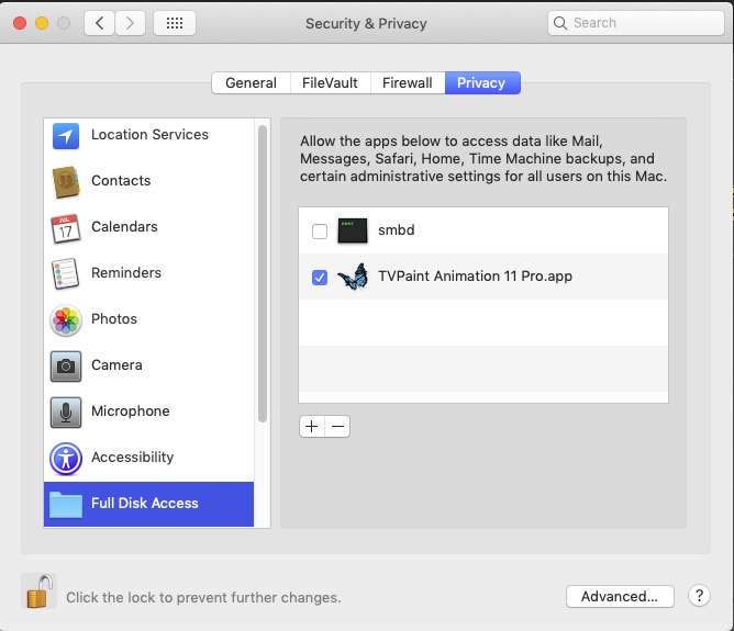

I don't know where to grant full disk access. I have full access by default. I didn't think about this limitation. I do not understand. The error is sometimes there is sometimes not. I'm getting used to.

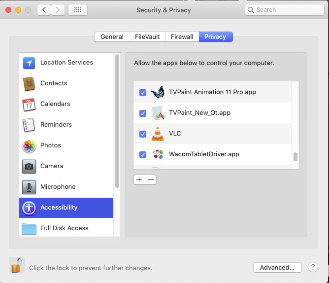

System Preferences > Security & Privacy > Privacy > Accessibility add TVPaint as an application in the list.
and/or under Accessibility , in Full Disk Access
Screen Shot 2021-03-09 at 2.05.01 PM.jpg (62.89 KiB) Viewed 7246 times
Screen Shot 2021-03-09 at 2.08.36 PM.jpg (63.88 KiB) Viewed 7245 times
