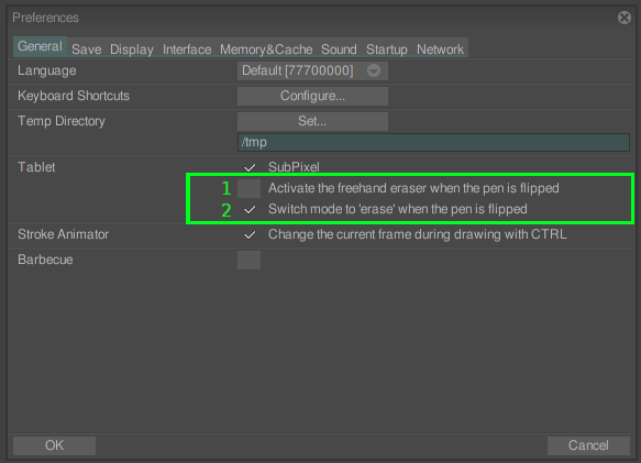

Since the latest update for the Linuxversion TVpaint no longer remembers which brush I had been using before and now defaults to eraser after every restart.
Is there a way to restore the default behaviour?
Re: TVPaint Animation Release 11.5.1 update (2021-03-15)
Posted: 17 Mar 2021, 11:09
by Xavier
deruji wrote: 16 Mar 2021, 17:38 Since the latest update for the Linuxversion TVpaint no longer remembers which brush I had been using before and now defaults to eraser after every restart.
You probably use the upper tip of your pen, right ?
Check your "General" settings, which one do you have ?
These checkboxes are exclusive, you can enable only one of them at the same time.
  • If you check the first (#1 on the picture), you should get the freehand eraser tool when you use the pen eraser (the upper tip).
  • If you check the second (#2 on the picture), the drawing mode should change to erase when you use the pen eraser.
  • if you check none of them, then you can have a separate brush at the tip of your pen :)
Posted: 20 Mar 2021, 17:02
by deruji
I use both ends of my pen. The front to paint, the back to erase.
I neither want nor need TVpaint to automatically determine what my eraser is. Most of the time I do not want my eraser to be based on the brush I'm using.
The previous behaviour was so that I could use 2 seperate pens each with different properties for the front and back tips. Now they both default to an eraser for the front and back.
Posted: 22 Mar 2021, 16:55
by Xavier
Usually the eraser is configured by the tablet driver. On Linux it's a bit more complicated, since there's no official Wacom driver. Maybe this : https://linuxwacom.github.io/
If you prefer not to have the eraser mode when you use the top tip, you can have the free hand eraser (enable #1) or the brush you want (disable both).
I encourage you to test the different modes: try what you prefer having #1 or #2 enabled, and try also disabling both.
Posted: 23 Mar 2021, 01:28
by deruji
I have tested all modes, hence my post.
I'll see what options linuxwacom offers.
