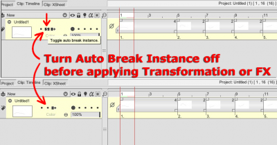

Toggle off the Auto Break Instance before applying the Transform Tool should work to retain the layer structure. I'm unsure why you are getting different results.

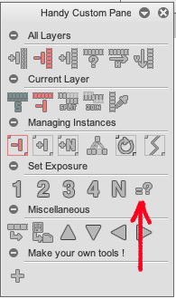

Another option is to click on the =? icon in the Handy Panel which will recompute the instances to their original exposure.
Screen Shot 2021-03-26 at 8.10.39 AM.jpg (54.14 KiB) Viewed 4883 times

Thanks! This really helped me out!
I totally missed the layer icon where I can change the auto-break settings.
This was exactly what I was looking for.
