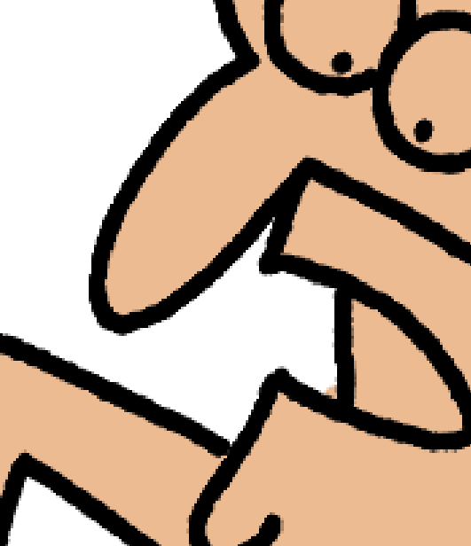

This is one of the examples from the new tool. It sometimes draws outside of the line art. And some spaces are kept empty when I would like to have them filled.
With the previous tool from Lukas this never happened....

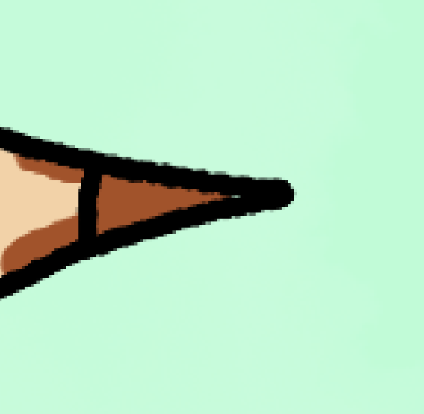

This is an example from a gap within a drawing...(maybe it's not easy to see but its a pencil)

Posts: 4517
Re: Some TVP 10 scripts don't work in TVP 11
Hey Joost,
Those artifacts in your posts look like gap closer roundings, these usually appear in sharp corners.
Because you always have neatly closed shapes the Gap Closer value can be left at zero, which should minimize them.
Then the color Range can also be set pretty high because your lines are always nicely black.
And you could set an Expand on the fill, since you have quite thick lines you could safely set the expand to a value between 2 and 4.
Expand will result in the color filling
halfway under your lines, eliminating those little holes.

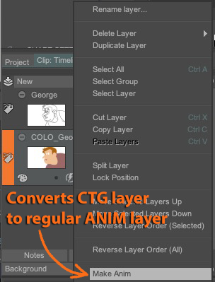

I also wonder if instead of Fill Inside (filled stroke) adding fill colors using CTG method may suit your purposes better ? (in TVPaint 10 , you might know CTG as "LazyBrush") . CTG fills are fast and precise. (*UPDATE: see my post below responding to Svengali's new version of his FigFill script. Svengali's script is faster for filling a character with a single color. The reason I mentioned CTG for doing the color fills was because I saw that a few of your sample frames had more than one color. )
https://www.tvpaint.com/doc/tvp11/index ... l-concepts
https://www.youtube.com/watch?v=FDjQNvbgzmw
The downside of using CTG layers is if you need to share the file with people who do not have TVPaint 11 PRO (for example TVPaint 11 Standard or TVPaint 10 Pro/Standard) then CTG layers will be invisible to them if you share your .tvpp file with them. The workaround is to duplicate the project , convert all CTG layers to regular ANIM layers, then you can share it with someone using TVPaint 11 Standard or TVPaint 10 Pro or Standard and they will be able to see the color fill layers when they open the file.
