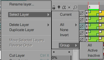

Hi, I'm going to refactor the selection menu.
What do you think of such options ? (they will be associated to keyboard shortcut functions, of course)
Capture d’écran_2021-10-29_10-35-03.png (26 KiB) Viewed 45198 times
Capture d’écran_2021-10-29_10-32-13.png (28.38 KiB) Viewed 45198 times
Animationriver
Posts: 263
Joined: 02 Jul 2017, 09:04
Location: Moscow
Re: INVISIBLE LAYERS in one COLOR GROUP
Post by Animationriver »
Xavier wrote: 29 Oct 2021, 10:50 Hi, I'm going to refactor the selection menu.
This is genius.
But it has to do with one clip.
If you have the skill of organizing a project. I often use clips. The clip is my main tool.
Therefore, it would be nice to have a toolbox for all clips at once. Or a command for the selected clip only.
I'm a storyboarder.
This is very important to me. Be able to influence clips. Not just layers.
Thanks.
Your idea is perfect for 1 clip.
Thanks!
You will be very helpful! Thanks.
