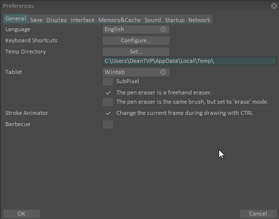

Hello Tao, in the preferences a new option allows you to choose the behavior for your pen's eraser tip.

Dean wrote: 17 May 2021, 09:23 Hello Tao, in the preferences a new option allows you to choose the behavior for your pen's eraser tip.
Hello Dean,
thank you very much! I've been looking for it everywhere. Cool that you can switch between these options now!
