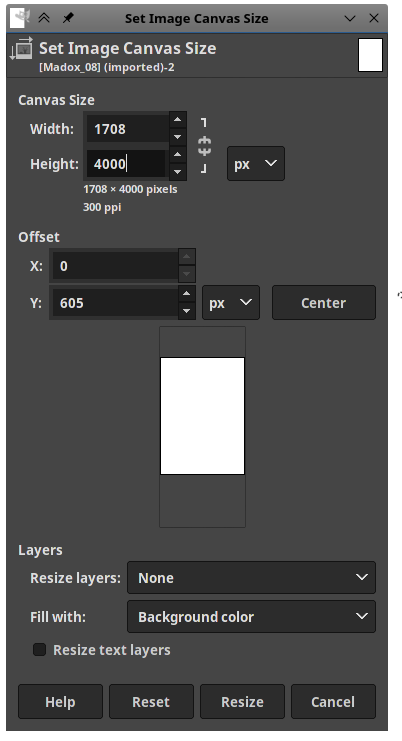

It would be nice to have an improved feature to be able to choose if the images/layers remain at the bottom or top of the canvas or in which direction the extension goes. Simliar to the resize canvas feature in GIMP or Photoshop.

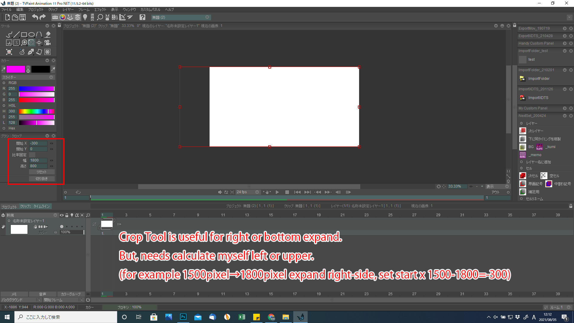

This operation is possible with the crop tool.
However, since the origin is fixed at the upper left, it can be easily expanded to the right and bottom, but for expansion to the left and up, you need to calculate the starting point yourself.
As a solution to this problem, I have created a panel called Resize Project and published it on the Japanese user forum.
This panel still has some inconveniences, it doesn't have an interface and you can only specify how many pixels are plus or minus in one direction.
I hope this feature will be added to TVPaint itself.

Hironori Takagi wrote: ↑05 Aug 2021, 05:21 This operation is possible with the crop tool.
