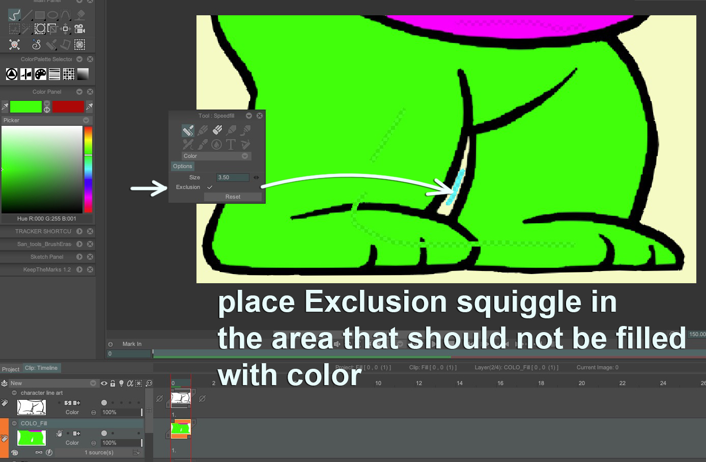

when you click on the CTG layer's little palette symbol in the layer panel, you'll see that in the appearing "edit colors "panel is, additional to the colors that you picked so far, a field (by default with a turquoise square) which says "Exclusion". You can use it with the CTG pen tool on gaps like the one in your image, and it will exclude the area from the paint surrounding it.

If it's overfilling like that , use an Exclusion squiggle to keep that area between the legs from being filled.
