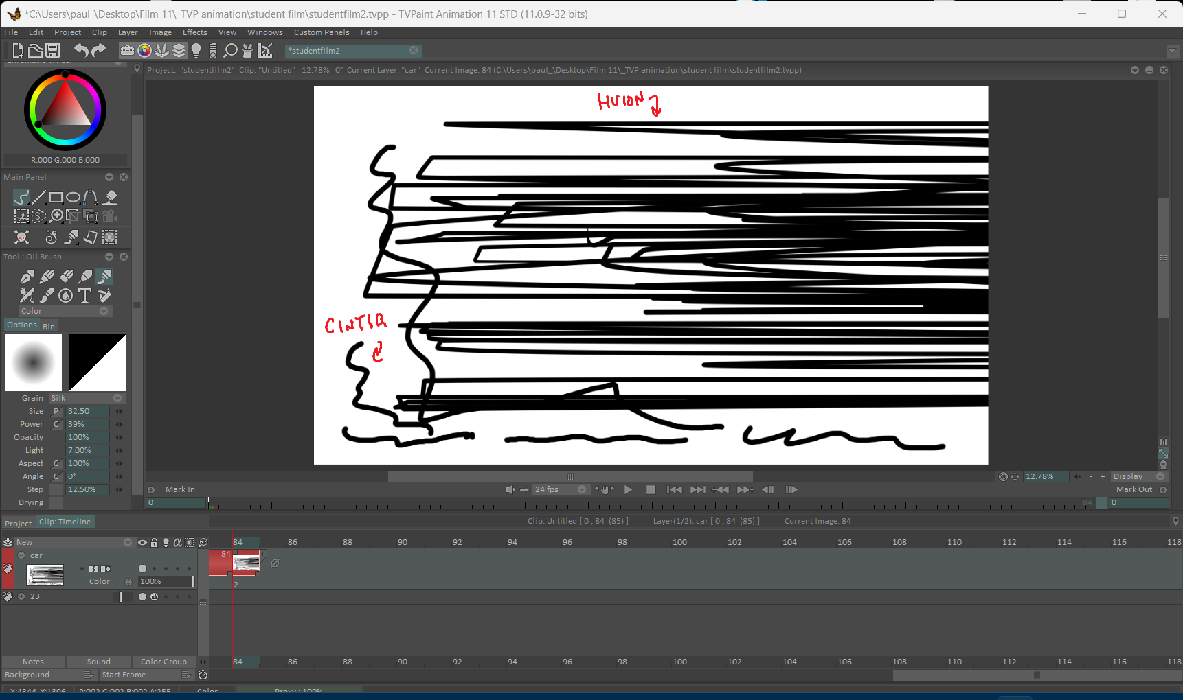

- Posts: 28
- Joined: 27 Aug 2022, 23:52
Re: TVPaint and Windows 11
So far Windows 11 has been terrible. Huion with "Wintab" means crazy horizontal lines, "ink" means no pressure senstivity. Cintiq gets no craziness but no pressure sensitivity either way. Tried changing all settings in Tablet PC settings, Wacom Tablet properties, and Pen and Touch. Will be going back to Windows 10 once I've wasted more than 8 hours trying to fix this.

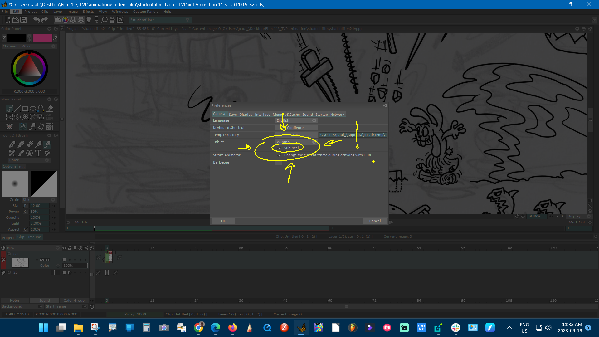

- Posts: 28
AHHHHHHH FOUND IT! Took about 4 hours, everything was screwy, had to switch back and forth between Windows Ink "on" and "off" to toggle between pressure sensitivity and right-click functionality, and just started clicking checkboxes, and randomly the "subpixel" box solved everything FTW!! Not sure what it's supposed to mean but to me it was the magical "fix everything" box, I'm back to Windows 10 functionality. Thanks to TV Paint for whoever created the magical box!!
