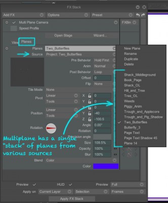

Very true. This is a point that could be emphasized more in the User Guide and Tutorials , in my opinion. I have come to the point where I almost never apply FX directly to the original layer, but instead I apply FX on a new layer (create Duplicate Structure layer is very useful for this) with the Source set to the original layer or Source set to another Project or Clip, or Source set to Images stored in the Image Library . Image Library is for me one of the most powerful features of TVPaint , but seems to be little known or understood by many users. The fact that you can use images stored in the Image Library as Source images to create FX sequences makes it much more efficient to create Multiplane Camera shots , for just one example .RjLikesToDraw wrote: ↑10 Apr 2022, 22:39 Doing a lot of effects seem pretty cumbersome and are destructive, so every time you attempt one you'd better be on a separate, blank layer.
I have worked on Multiplane scenes where I have layers of still artwork in the Image Library (originally created in Photoshop, transferred into the Image Library) , plus multiple layers of animation saved as DEEP (.dip) files , with each of the animated DEEP sequences open as separate Project tabs. In the TVP file where I'm compositing the final scene I have the Multiplane Camera FX with the various plane Sources set to either images in the Library or to the animated sequence projects (DEEP files). To keep all of these source files from being lost I create a single folder where the original Photoshop files , the various DEEP files and the .TVPP file are all stored together (similar to how an After Effects project has a folder called Footage where all the source files are stored).
The Multiplane allows you to add multiple planes into a single Multiplane FX , but if you're using this multiple source files from Image Library/Clip List/Project List technique with the KeyFramer then you have to open a new KeyFramer FX for each layer , so you literally have a "stack" of KeyFramer FX in the FX Stack one on top of the other (the position of these Keyframer FX in the stack can be changed by dragging them up or down in the stack.)
(click on images to view larger)
