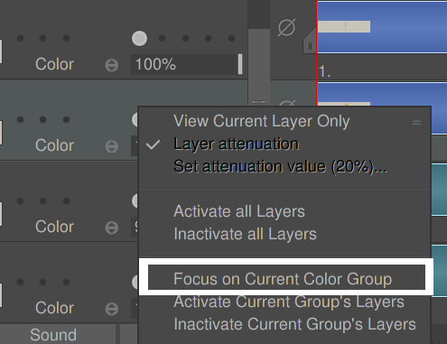

I remember implementing a similar "focus" function, that is available when you right click the visibility button :
Capture d’écran_2022-01-26_20-36-17.png (47.06 KiB) Viewed 9254 times

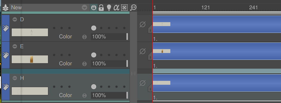

Currently it works with the color groups only :
Capture d’écran_2022-01-26_20-38-19.png (35.79 KiB) Viewed 9254 times
