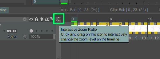

Thanks for the recording. Have you tried changing your layer zoom level ? Click on the lens button and mouve your mouse :
Capture d’écran_2022-02-01_13-40-05.png (22.38 KiB) Viewed 4125 times
Also watch when you click : when grabbed, the handle should change color.
Apart from that, you're right it seems that the handle area is a little too wide. I'll reduce it.
