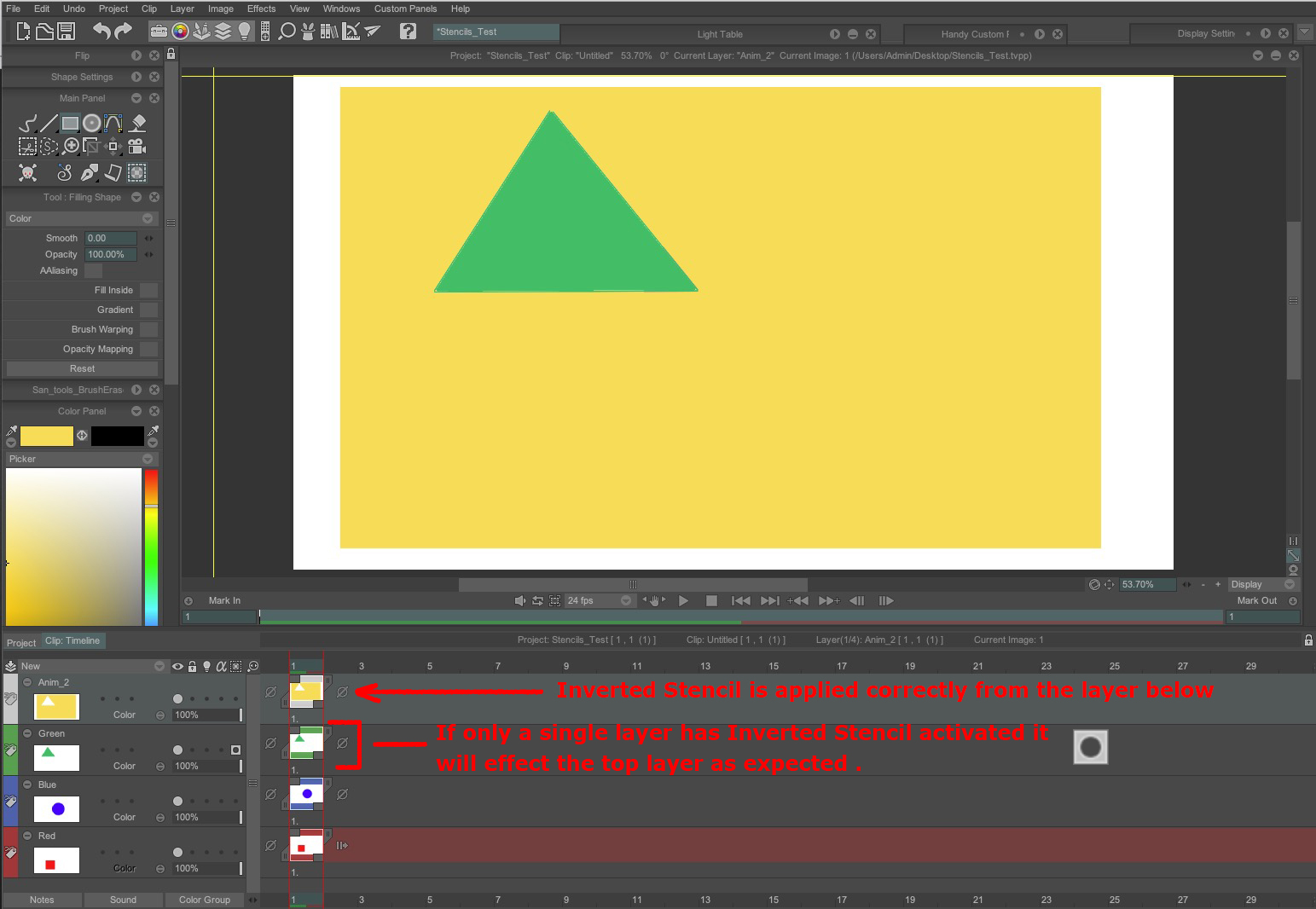

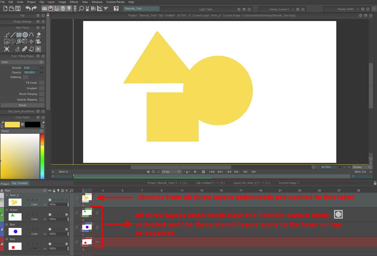

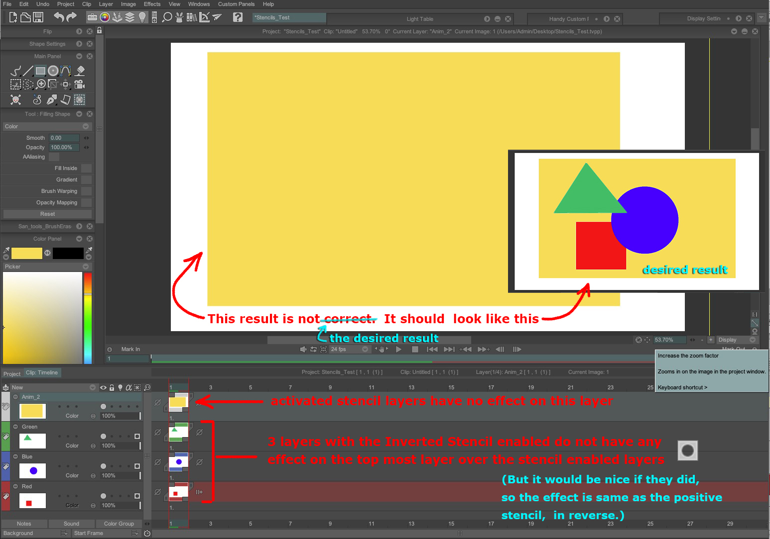

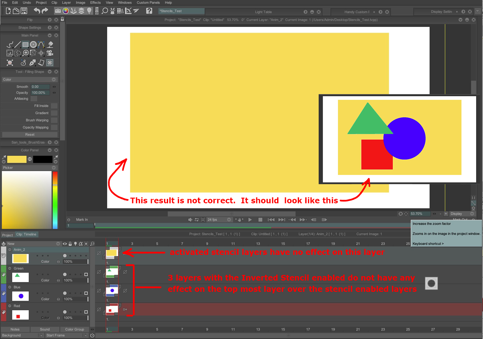

It seems there is an inconsistency in how stencils (which are referred to confusingly in the User Guide as both "Masks" and "Stencils", but that's for another discussion ...) are applied.
A positive stencil
activated on more than one layer will apply to another layer on top of the activated stencil layers.
However, if you use the inverted stencil
activated on more than one layer it will not apply correctly. The inverted stencil only applies from a single layer.
The attached images demonstrate the inconsistency.
Positive Stencil mode activated on more than one layer is applied correctly: (click on the images to view them at full size)
Inverted Stencil mode activated on more than one layer does not apply :
Inverted Stencil mode activated on a single layer applies correctly:
Or see screencap movie: https://www.youtube.com/watch?v=DPv-ej3DFQQ

Re: combined masks
I stand corrected. Let me amend my comments/screenshot above to: "This result is not correct the desired result. It should look like this. (to make more sense in an animation workflow, so applying combined inverted stencils gives the same result as combining positive stencils, but in reverse. Not mathematically logical , but it is a desirable result.)"Peter Wassink wrote: ↑10 Apr 2022, 13:56
Sven is right off course and mathematically this makes sense.
But it does not necessarily make sense in a animation workflow ... In practice you would often want to be able to get the result that David shows, basically inverting the combined result of a group of masked layers.

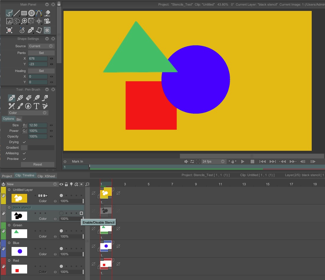

One extra layer (layer 4.) - an inverted stencil activation will will "mask" in the manner you want/need when all the following steps are implemented.
1. create the three overlapping red, green, blue shapes on three lowest layers.
2. turn on normal stencils for the shapes on all three layers.
3. on a next, higher layer, stretch a black filled rectangle over the whole frame which will generate a new, black shape that will have a cumulative contour following the three original shapes.
4. set the inverted stencil on for the black layer (you should deactivate the layer... but the "masking effect" will still work in step 6.)
5. the next step is critical - be sure to turn off the stencils of the red, green and blue shapes.
6. on the final top layer, stretch a yellow filled rectangle over the whole frame which will generate a frame-filled yellow shape that has a cutout where the red, green and blue shapes' edges were. The original color shapes will show through the cutout hole in the filled yellow layer.
A script could automate the entire process...

Re: combined masks
Svengali wrote: ↑11 Apr 2022, 06:39 One extra layer (layer 4.) - an inverted stencil activation will will "mask" in the manner you want/need when all the following steps are implemented.
(S)Venn![]()
Thank you for explaining this process to me. (as with so many of your posts I will nominate this one to be incorporated into the User Manual with some screen shots or a screen capture video showing how it works)
