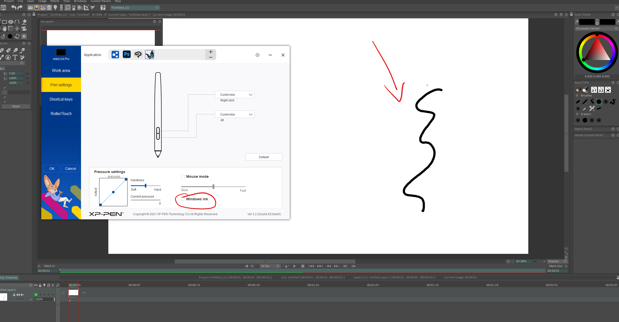

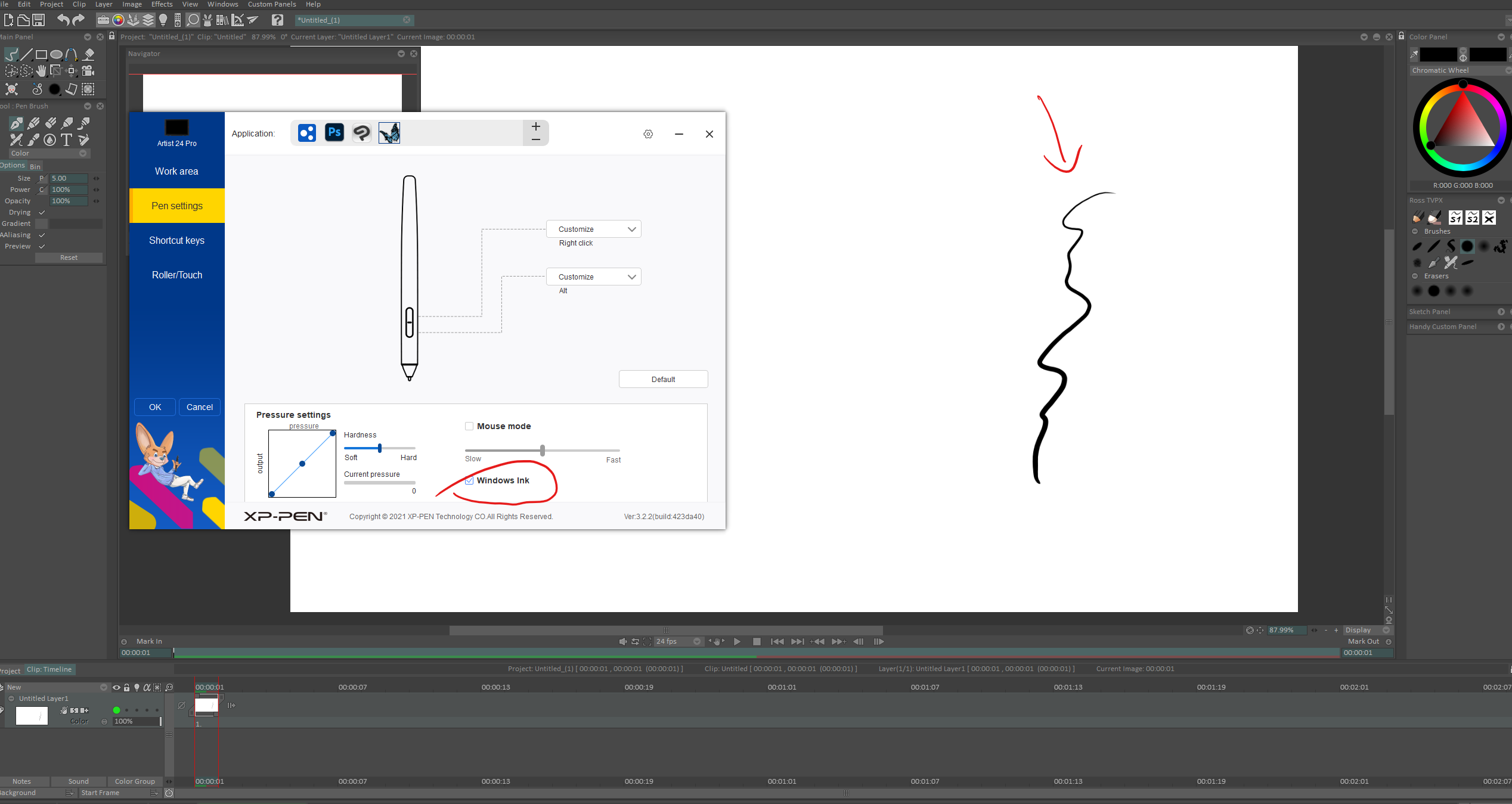

I did some more experimenting with this and noticed that the "windows ink" option in the xppen driver settings can toggle the issue with some caveats.
When windows ink is on, the pressure sensitivity works in TVP but I cannot get right click or any mouse functions to work on the pen buttons. See images attached.
When it is off, all these shortcuts work but then there is no pen pressure.
I would really like a solution for this please. Thanks

Windows Ink turned off
Windows Ink turned on

Posts: 1143
Re: Xp pen Artist pro 24
Hello, is the Subpixel option enabled in the General tab of your Preferences?
Also, was the TVPaint XP-Pen driver profile created before you updated TVPaint or after?

Dean wrote: 04 Apr 2022, 09:36 Hello, is the Subpixel option enabled in the General tab of your Preferences?
The subpixel option is off. I tried turning it on and off but there was no difference in the issue.
I never had to "update" tvpaint per say but I have had Tvpaint 11.5.3 for about a month now and I only got the xppen last week.

Posts: 1143
Is the drawing mode in the General tab of TVPaint set to Windows Ink as well?
