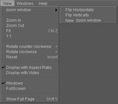

Is there any updates in regards to this subject?
It is a very big wish for me as well. At the moment I export out my scene and flip the preview in PdPlayer, -BUT it would be very much appreciated to stay inside Tvpaint..
hisko
Posts: 581
Joined: 03 Nov 2006, 19:43
Re: flip project horizontaly
Post by hisko »
It has been implemented a long time ago. It is a fantastic feature that I use often.
Go to View- Flip Horizontally
That's it.
If I'm not wrong (I'm on the bus without à TVPaint to check this), the shortcut is ] or [ to flip horizontally.
