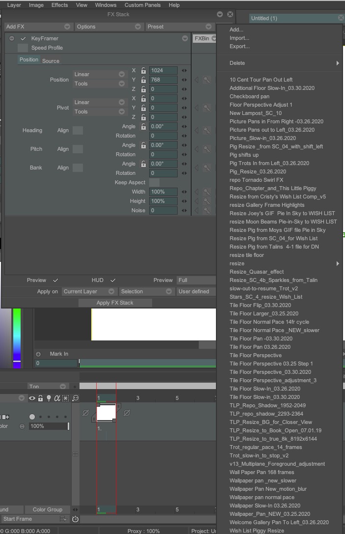

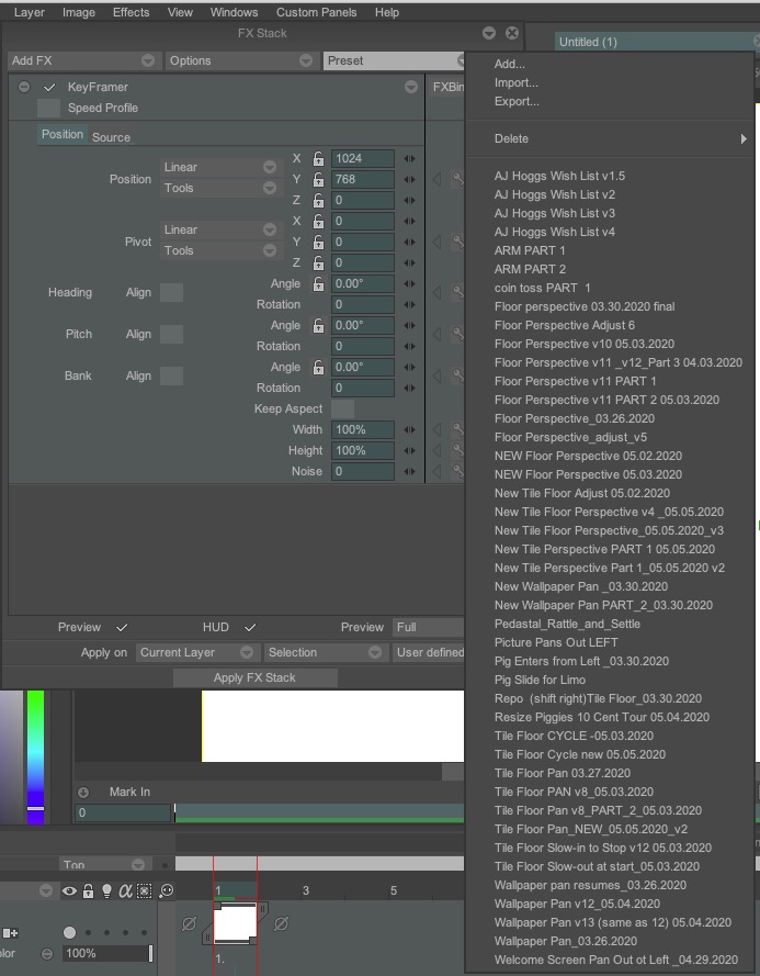

When I save FX to the Presets or the FX Bin in the FX Stack, where are those FX .bin files stored ? I have a bunch of them that I don't want to have to Export and Re-Load one at a time, but instead would like to find them in my old configuration so I can copy and paste them into my new configuration. (if that's even possible ?)
I don't where to find these saved FX .bin files.

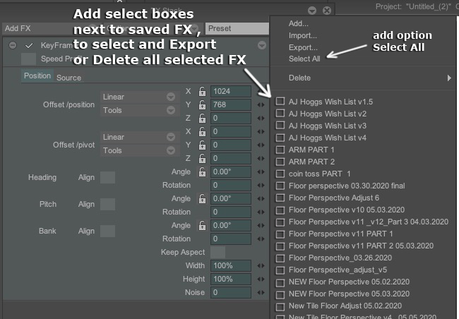

Would it be possible to add Select boxes next to each of the saved FX in the Presets bin or the FX bin so that a group of saved FX could be selected and then Deleted or Exported as a batch action rather than having to Export or Delete the saved FX one at a time ? So the option would be to put a check mark in a box next to each FX you want to Export or Delete (and also perhaps have a Select ALL option if you wanted to Export or Delete all the saved FX in the list ).

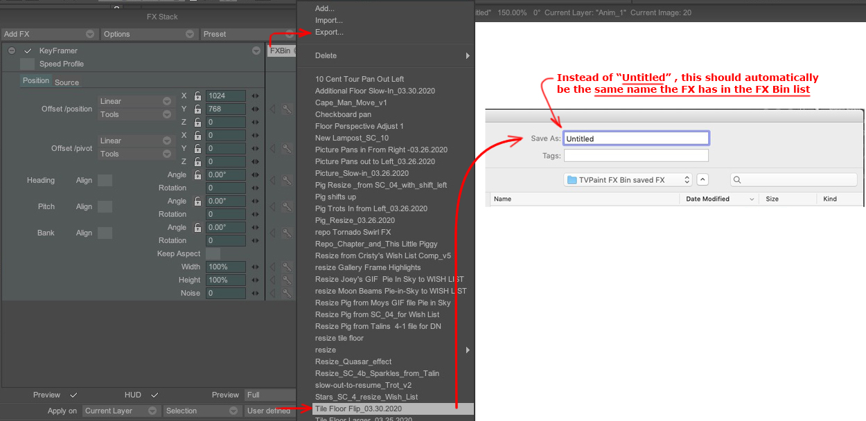

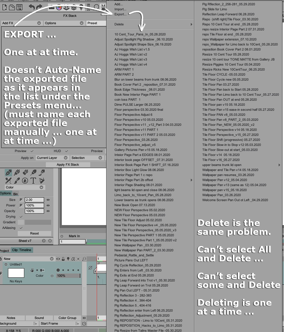

As it is now if you want to Export an FX in the list to make a back-up of the FX in a folder so it can be re-loaded into the FX Stack at a later time the FX have to be exported one at a time and they must be manually named when Exporting. (by default when exporting a FX from Presets or FX Bin the file is "Untitled". I believe the behavior should be that it is automatically named with the name as it appears in the FX Bin list. ) The same thing with deleting: if you want to delete a single FX on the list or multiple FX on the list (or ALL the FX on the list) you must do it one at a time , which can be very tedious if you have many old FX saved in the bin.
Here is the problem as it exists now. Each saved FX must be Exported (or Deleted) one at a time.
What I am proposing with select boxes next to each saved FX so you could select which FX you want to Export or Delete,
and the option to Select All , then you could Export All or Delete All if desired.

Then , upon Exporting an FX from the Presets or FX Bin, the exported FX file would automatically be given the same name it has in the FX Bin list , rather than showing up in the Export panel as "Untitled". It already has a name in the FX Bin list , so just automatically give it that name when exporting , rather than forcing the user to take time to type in a new name for it.
However, I will say that this thing about the file name showing up as "Untitled" when exporting it seems to me that it is a BUG which should be fixed rather than considered a "new feature" request as such. If a file already has a name assigned to it in the Presets or FX Bin list that name should be the name that shows up in the Export panel , right ? Why have it show up as "Untitled" ? It already has a title (name).
