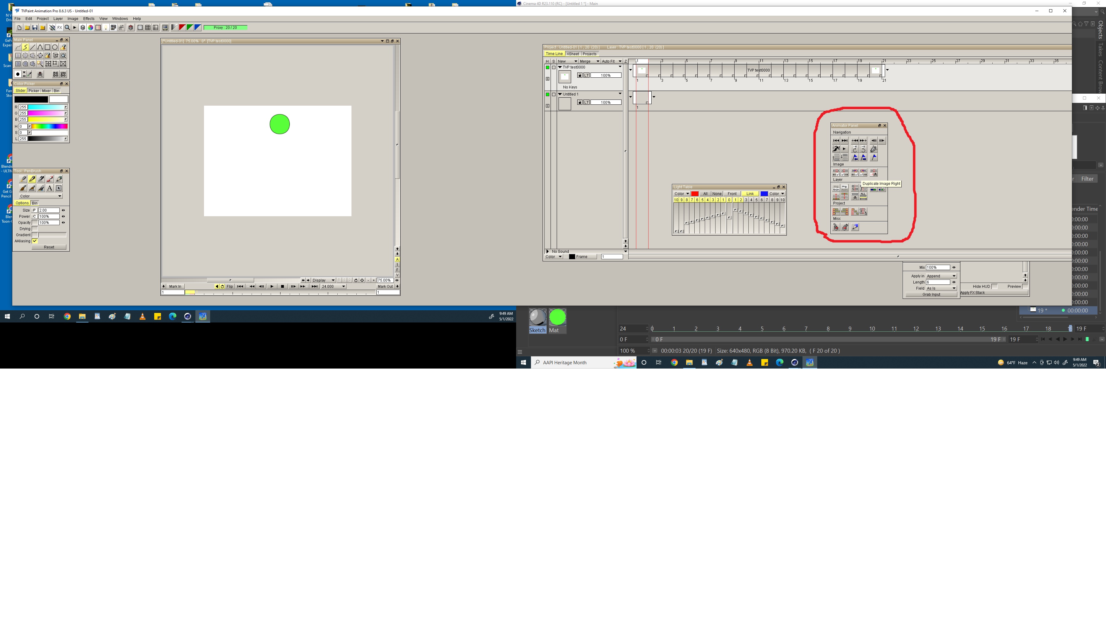

In TVP 8.6.3, lets say I have a 3D render on 1's of 150 frames. I can select all the instances or drawings on the layer. And then I can use a feature called "Duplicate Image Right" (see screenshot.) I push the button, and all of the images on 1's are repeated. It only takes one click to repeat all 150 images, (or instances, and they are now called.)
The "Duplicate Image Right" feature is a part of something called "Animator's Toolkit." Maybe "Animator's Toolkit" was from a 3rd party vendor.

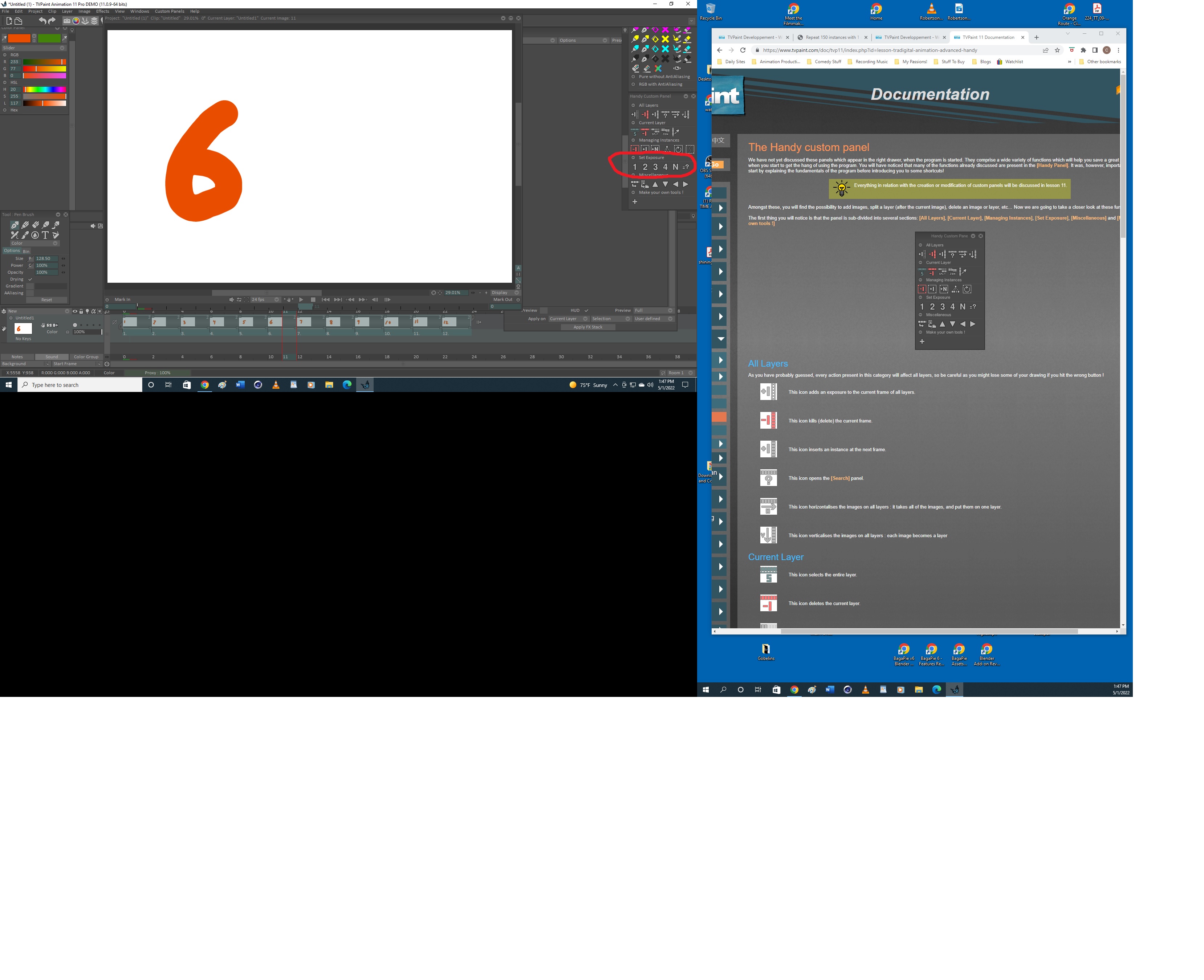

I admit my question was complicated, or even badly written. But I knew that in 8.6.3 you clicked on the +1. What I was asking was "could you do that in 11.5? And if so, how?"
But your response led me to the documentation, and I found the Handy Custom Panel. I and figured out how to select all and choose "Set Exposure" in the Handy Custom panel. So the mystery is solved.

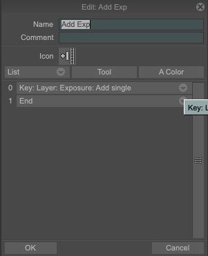

I made my own action for it in TVP 11.5 (Since I also couldn't find it)
Screenshot 2022-05-02 at 08.38.42.png (16.06 KiB) Viewed 4208 times
Make custom panel, add an action, find: key:Layer:exposure:add single and it should work...
I think this should fix your problem, right?

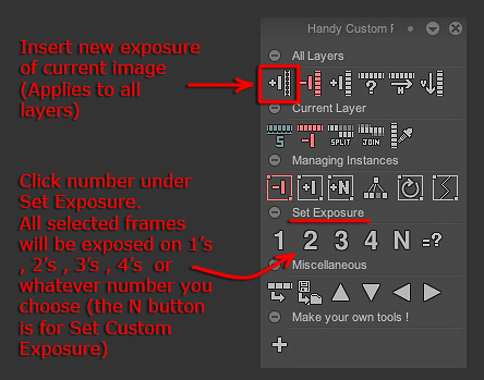

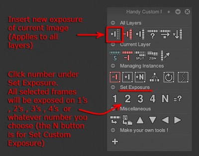

That will work, but it does already exist in the Handy Custom Panel. https://www.tvpaint.com/doc/tvp11/index ... nced-handy
Lol, there it is! How could I have missed it. Thanks!
