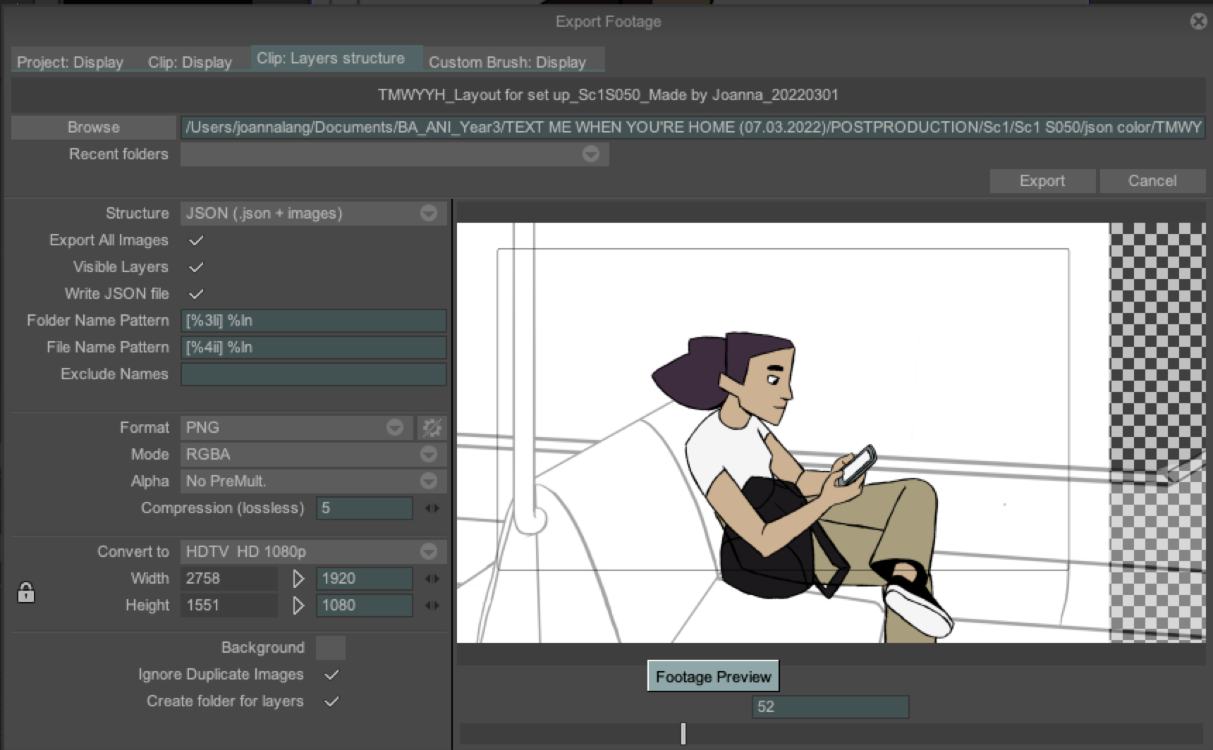

I’m an animation student working on my graduation film and I’ve encountered a problem when exporting my animations with JSON (PNG + RGBA).
If I open the exported folder, all the PNGs for my clean up lines are there but for every single colour layer, there is just 1 blank PNG.
I am confused because back in March I exported other shots with the exact same method (following the official TvPaint tutorial on Youtube) and the same TvPaint version and I did not have this problem. I tried reexporting those shots today and it doesn't work for them either.
The colours do appear however if I export my layers as one PNG sequence or a video file. The issue seems to be specific to JSON.
I tried updating TvPaint but the problem remains.
You can see my export settings in my attached file.

Try these settings to see if they give better results:
Folder Name Pattern: %ln
File Name Pattern: %ln%04in
Screen Shot 2022-05-21 at 8.28.37 AM.jpg (29.83 KiB) Viewed 4543 times
You may also want to try changing the image format to TGA , RGBA .
Screen Shot 2022-05-21 at 8.42.42 AM.jpg (28.25 KiB) Viewed 4541 times

Hello D.T. Nethery,
Thank you for your reply; I tested all the settings you suggested but I still get the same results, sadly.
If I uncheck "ignore Duplicate Images" however, the right number of PNGs are exported for my colour layers, although they remain blank.

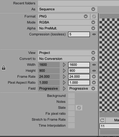

I don't know if this is related to my colour problem but I've noticed that even when exporting a clip as a PNG sequence, TvPaint ignores my transparency settings (RGBA + "Background" unchecked) unless I specifically set the Background type to "None" (Clip>Background>None). I could previously always export transparency with a "Check" Background as well, which is no longer the case.
That's the same setting I use (Background: None , Clip> Background>unchecked) , but the export on the color layers works correctly. (either exporting as a PNG image sequence from Clip-Display , or exporting as JSON from Clip: Layers Structure.)

Hello Joanna, the problem comes from the fact that your project is exported in dimensions different from the one you created it with (from 2758*1551 to 1080p), making the CTG layers' squiggles displaced and creating anomalies.
The easiest solution might be extracting the CTG layer's colors as bitmap layers (using the paint palette icon on their heads in the layer list) before exporting.
You can also resize your project before exporting it, but this might require a couple small adjustments with your CTGs' squiggles.
It must be hard for TVPaint to decide where the squiggles should be moved when there is less space on the workspace overall, I will see with the devs if they can add a warning message about this.

Dean wrote: 25 May 2022, 16:31 The easiest solution might be extracting the CTG layer's colors as bitmap layers (using the paint palette icon on their heads in the layer list) before exporting.
Oh, everything makes sense now! I tried the two methods you mentioned and they both worked as you said. What a relief! Thank you so much for your help! 8)
