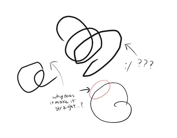

Hi! I just updated to the dematerialized version of TVPaint, and I've noticed my lines are jagged again. I used to be able to fix this by selecting preferences and checking off the wintab/subpixel option, however it is no longer there. I tried the Boost Line Smoothness option but I hate drawing like this because the line lags behind my pen. Is there any other way to solve this? I'm on macOS Big Sur just for reference. Thank you!

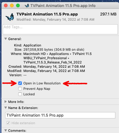

Well I hope someone from TVPaint Support will answer you soon about how you can fix this issue.
In the past when I have read about people having problems with brush lagging and jagged lines one solution mentioned is to set TVPaint to Open in Low Resolution.
Right-click on the TVPaint application in your Applications folder , select Get Info. In the Get Info window put a checkmark in the box next to Open in Low Resolution.
I don't know if this will solve your problem , but it is worth a try until someone from TVPaint Support will answer your question.

You can indeed try what David recommended above first.
I would need to know which graphics tablet model you are using (is it a screen-based one)?
