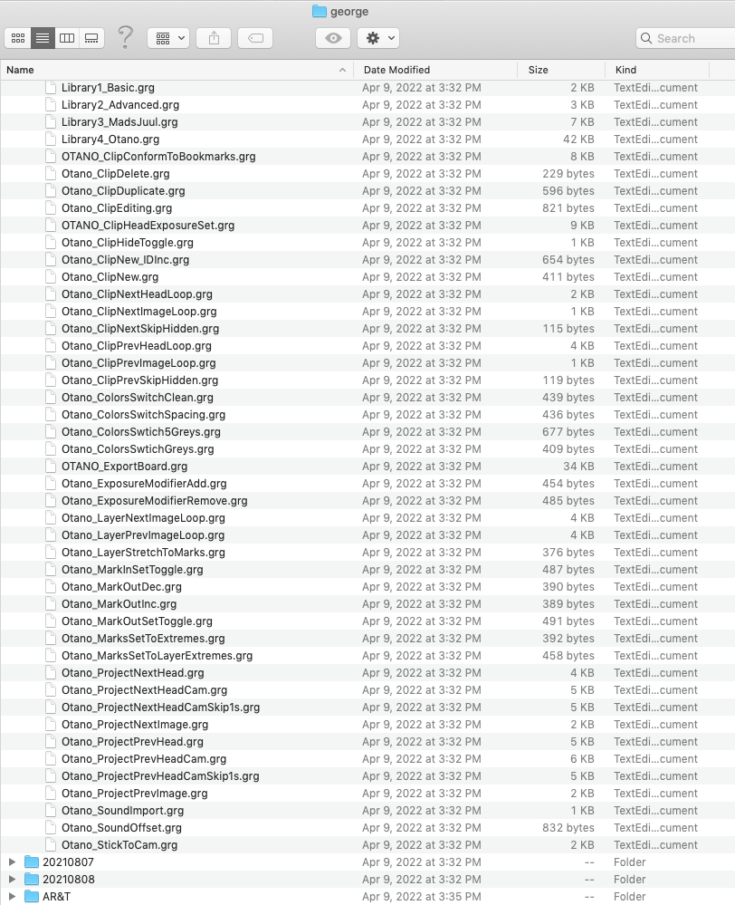

Re: Where's my George?
In my TVPaint folder (in Library) here is what I see inside the George folder:
But I think you mean something else ...

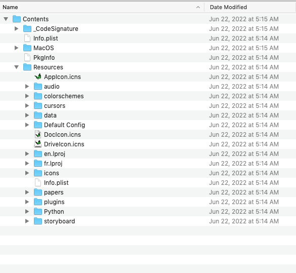

slowtiger wrote: 29 Jun 2022, 19:19 a George folder with the scripts in TVP/contents/resources as indicated in the manual, nor anywhere else.
If you mean looking inside the TVPaint/Contents/Resources I can confirm there is no george folder with george scripts. Where is this mentioned in the user manual?
( I can't find it. The user manual search function seems to be disabled at the moment)
Screen Shot 2022-06-29 at 5.33.05 PM.png (78.32 KiB) Viewed 3122 times
