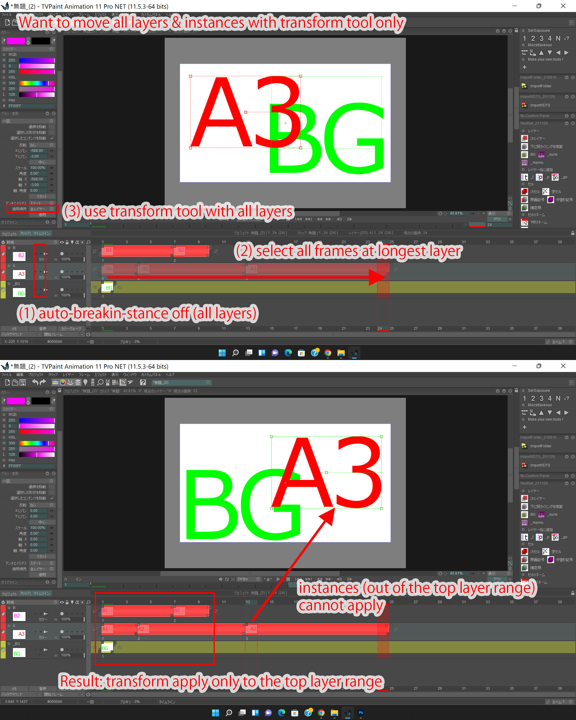

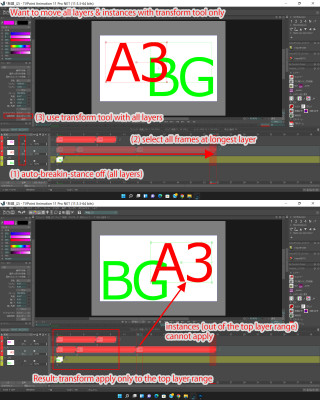

I have been asked several times by Japanese animators, "Is there an easy way to move all layers and instances together?"
The simple idea is to use the key framer FX, but Japanese animators only do the drawing work, so they don't usually use FX.
So I wanted to tell the staff how to move all instances of all layers with only the transform tool, but I noticed a problem.
・"Apply: all layers" affects the length of the top layer
Is this specification changeable?
Want to move all layers and instances with transform tool only

Hironori Takagi wrote: ↑22 Jul 2022, 08:13 I have been asked several times by Japanese animators, "Is there an easy way to move all layers and instances together?"
