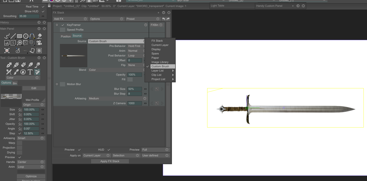

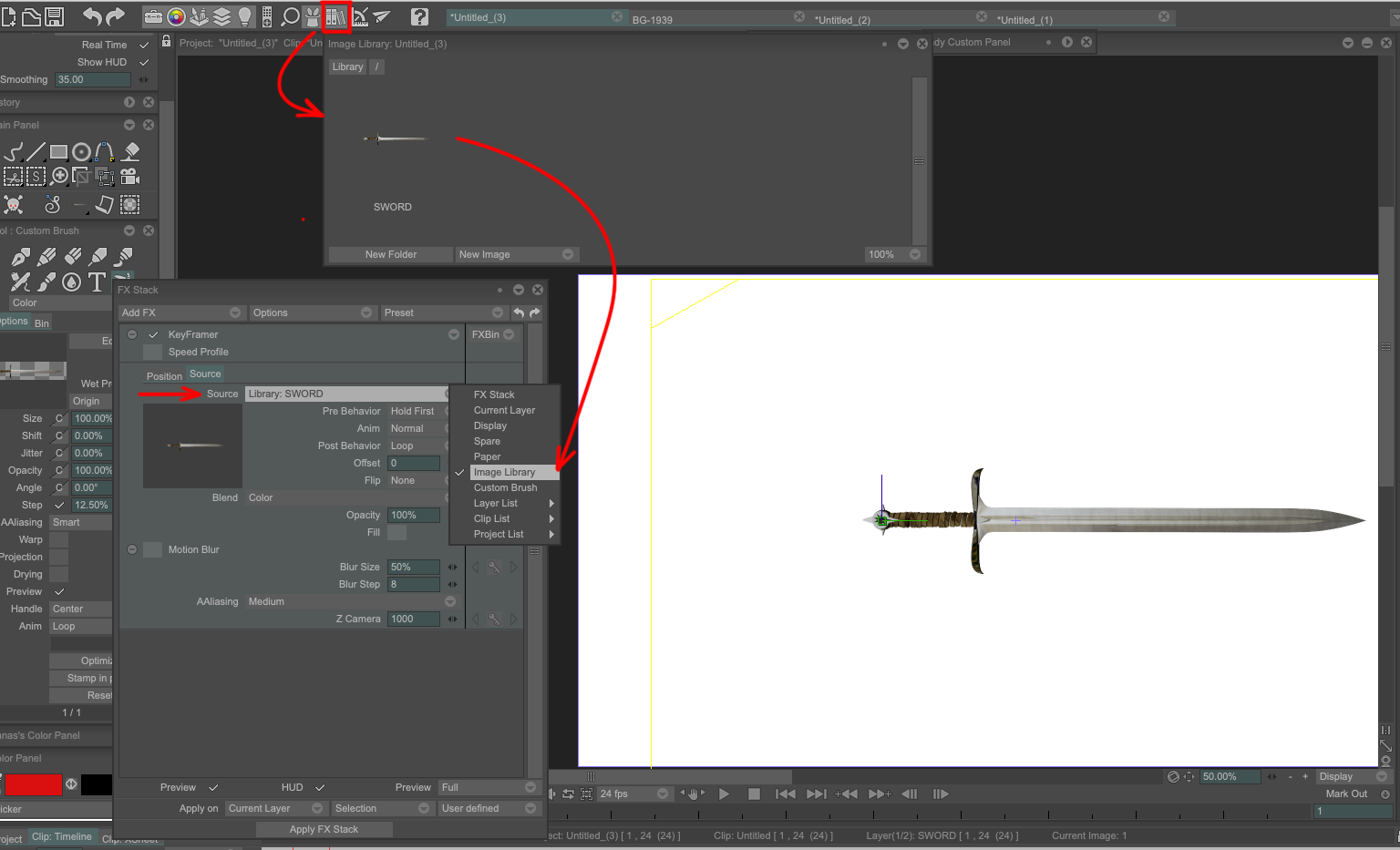

Use your single object (the key in your example) as a SOURCE image for the Keyframer, rendered on a different layer. The Keyframer's source image can be a layer , or in the Image Library , or a separate TVPaint project.
Create a new blank layer. In the Keyframer go to the Source tab. Set the source to your image in the Image Library , or on a layer , or a separate TVPaint project. Now set your keyframes for the move and click Apply FX Stack to render the move on the new blank layer. The original source image remains unchanged so you can re-do and re-render the move later on a new layer if for some reason there need to be changes made.
Image(s) stored in the Image Library Folder as source in Keyframer:
The source image in the Keyframer can also be an object that you have selected and cut to a Custom Brush.
This tutorial briefly demonstrates how to create a Custom Brush from an object in TVPaint and set a custom Pivot Point handle on the brush, save the new Custom Brush to a Custom Tool Panel , then go into the FX Stack -- KeyFramer , and set the KeyFramer SOURCE as the Custom Brush. You can then Keyframe the Angle to animate the object pivoting from the custom pivot origin point that you set on the Custom Brush. (no voiceover instructions , but click on CC to turn on the Captions to see text instructions.) https://youtu.be/0nJ-34uQIYo
(if you want to view this in Full Screen mode
you must click through to view it on YouTube)
