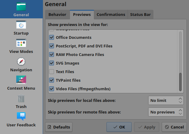

Hi, I'm trying to get TVPaint's thumbnailer to work in Linux Manjaro KDE so that thumbnails display in Dolphin.
If someone more knowledgeable could help if something's missing or say if it's impossible to implement, that would be great.
I tried looking at similar configuration files and adjusted paths where needed. Although I can get the entry to display as an option, no thumbnails are being generated or displayed in Dolphin.
I modified .thumbnailer file to be in line with others of the same type

The .desktop file is recognized by Dolphin and I can select it for previews.
It writes "tvpaintthumbnail" into the [PreviewSettings] section of Dolphin's config file "dolphinrc", but that's the only effect I've managed to get so far.

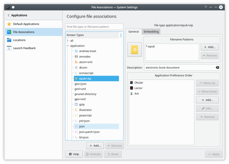

First guess : I'd think that you need first to create a MIME type for the *.tvpp extension :
https://userbase.kde.org/System_Setting ... iations/en

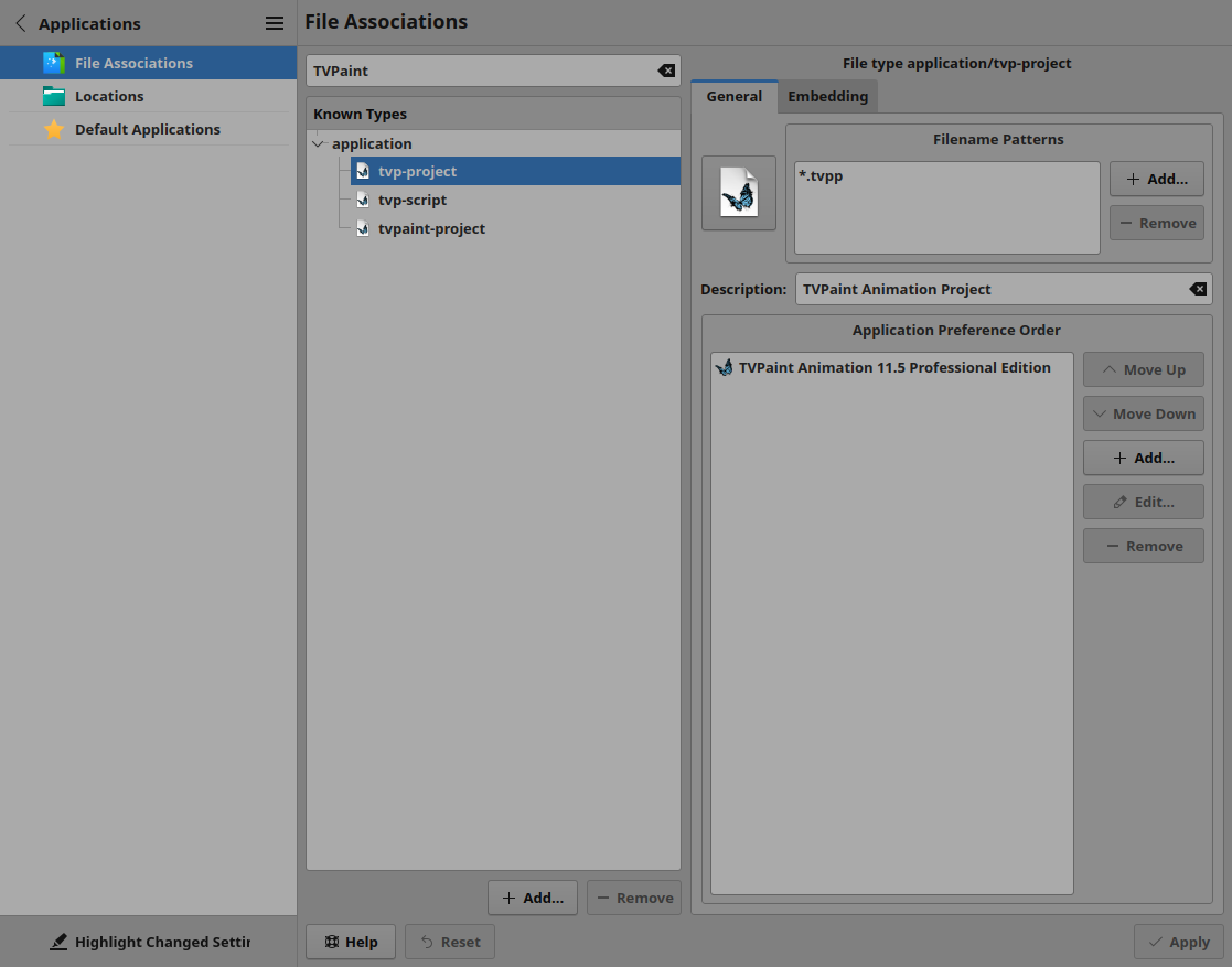

Thank you for the suggestion. The MIME types are already made as far as I can tell and filled with a wide variety of associations.
Would any specific MIME types need to be included in the .thumbnailer and .desktop files?
I don't know what internal file types are used to store the frames, if that is what the thumbnailer is looking for.

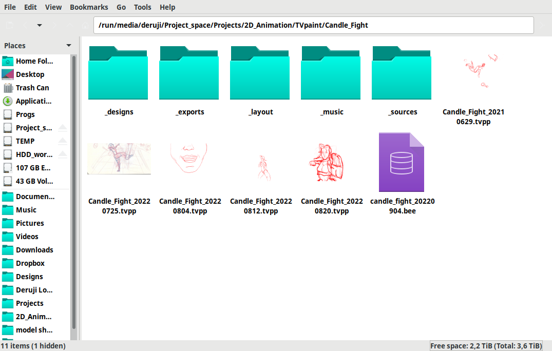

I tried installing a different file manager "PCmanFM" to see if the problem was also there. It directly accesses thumbnailers set in "/usr/share/thumbnailers".
It was able to generate thumbnails, so I can at least confirm that the thumbnailer itself is working in Manjaro. The problem seems to be in how Dolphin is accessing/not accessing TVPaint's thumbnailer.
