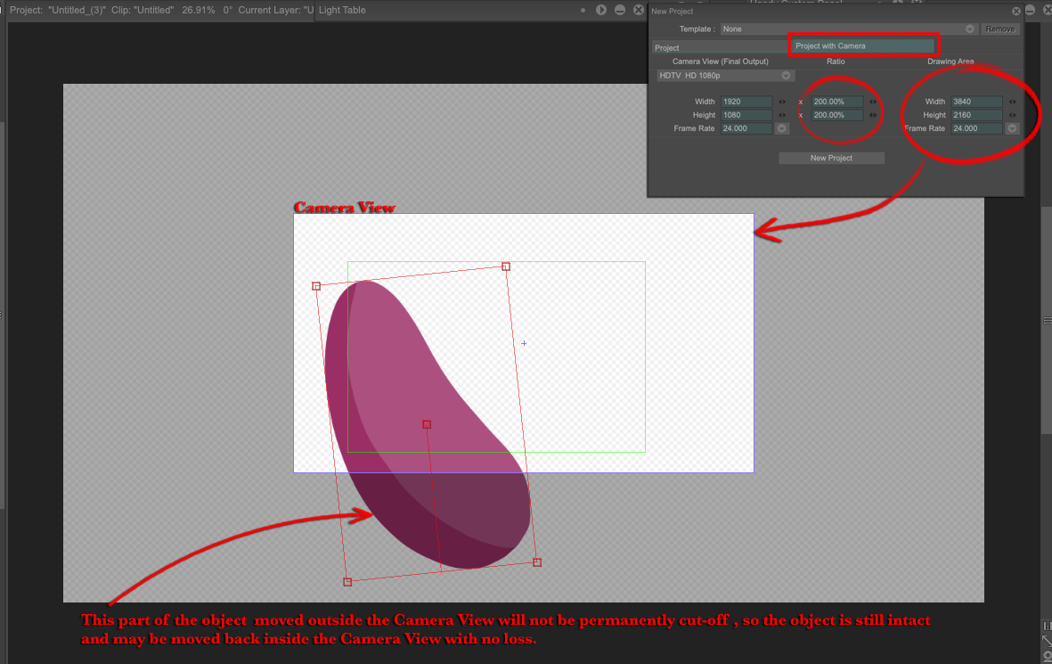

I wonder if cf-mankit is asking for this feature with reference to TVPaint Standard Edition, which does not have the Camera Tool like the Pro Edition ? Otherwise, the Camera Tool works perfectly for the task described.Peter Wassink wrote: ↑19 Sep 2022, 11:03 4) This one i don't understand, you can already do this. So what is it you are asking for precisely, why do you not want to do it with the camera?
Using Project With Camera View is also a sort of workaround for the first request: by setting an oversize project size with Camera View so there is a 200% (or more) border area outside of the Camera View window), which allows objects to be moved around outside the Camera View area and parts of the object will not be permanently cropped by the edge of the canvas if the object is moved outside the edge of the Camera View (so the intact object can easily be moved back inside the Camera area with nothing lost) .
I think it is a reasonable request to add what he is suggesting to TVPaint Standard Edition. It would still mean that the full Camera Tool remains a "PRO" feature, but the Standard Edition would allow users to define a work area (1920 x 1080) inside of an overscale project/canvas area , and upon exporting only what is drawn within the work area will be exported.
