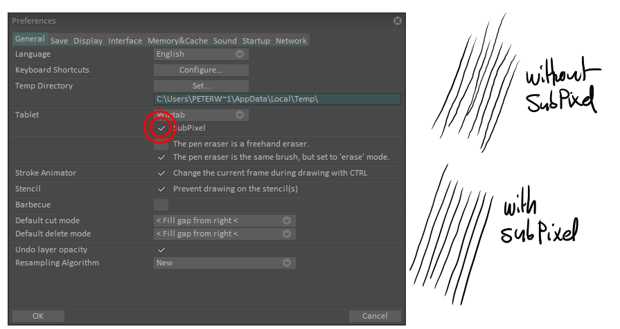

Hey Michael, one thing you can check that can help with the jagged line part...Sewie wrote: ↑16 Sep 2022, 10:54
Now the most important thing is this: These problems only seem to occur with the Line Smooting switched on! If I turn it off, my brush lines are horribly jagged. Absolutely more so than my hand would naturally be. So switching the Line Smoothing off is no option in my work.
In the preferences, when in Wintab mode, do you have subpixel option switched on?
this should give a rather dramatic improvement in linequality
- subpixel.png (77.58 KiB) Viewed 11562 times
Re: Performance issues with drawing and selection tools in the dongleless version 11.5.3
Hi Peter,
Yes, that does give a dramatic improvement in line quality when drawing! But then when I use my pen button (I have it set to 'right click') to navigate my project window, it doesn't react well. I can't zoom in and out for example.
(For zooming and out I'm using the 'alt' button on the keyboard and the pen button on the side of the wacom pen (set to 'right click')).
This won't help much when working since navigating freely over the project window to be able to work on my drawings is extremely important.

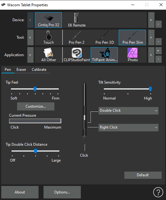

Does the Subpixel option prevents you from using your stylus shortcut buttons?
Could we have a look at your Wacom driver pen settings windows, please?
Yes, when Subpixel is selected, I can't zoom in and out. Like I mentioned above.
My Wacom settings are below.I should add that I have WIndows Ink turned off in the Calibrate tab.
