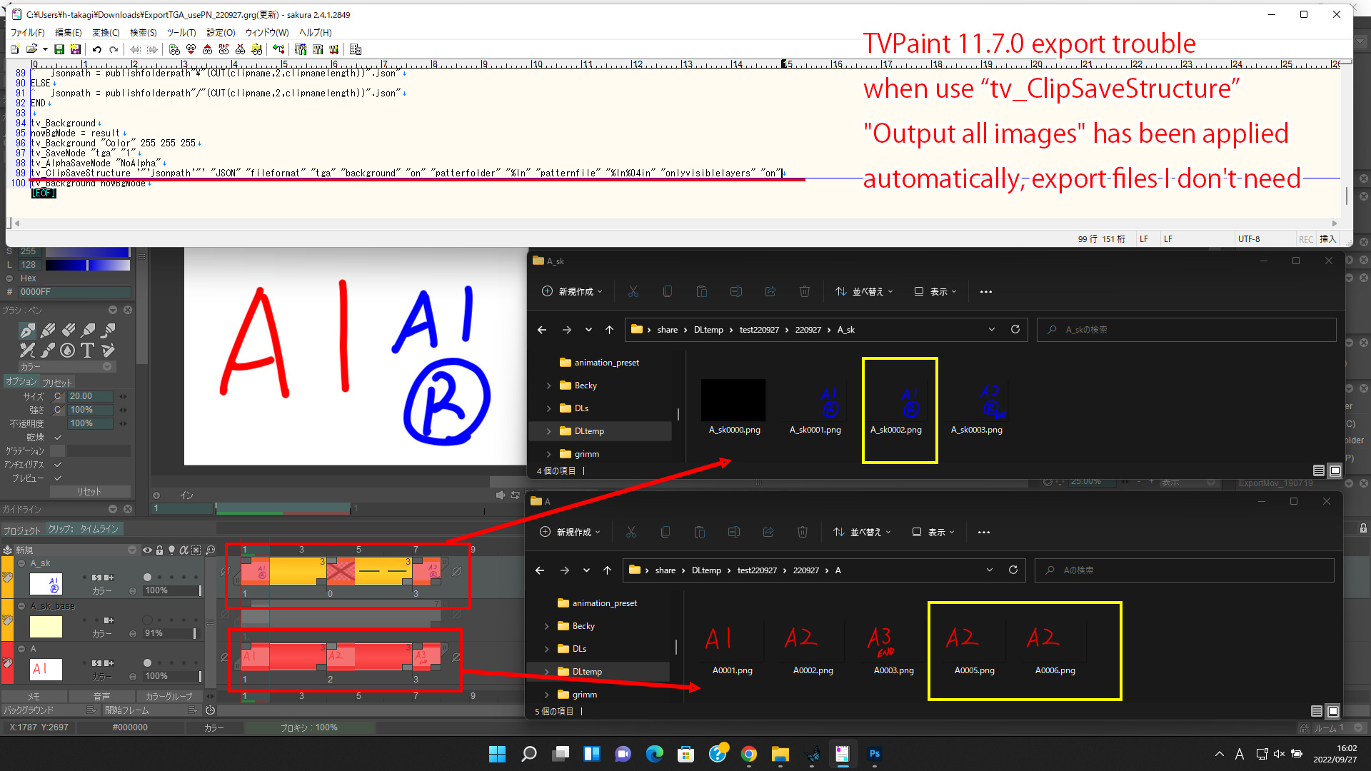

I found one more problem with the export.
The following update of the release note has caused a problem for the operation so far.
When exporting named images (instances where the name is set by the user instead of the default name), the “All Images” checkbox should correctly export all images (1 frame = 1 image file).
This rule will create wasted frames in TVpaint 11.7.0 when using George "tv_ClipSaveStructure" command (export heads of the instance).
Please let me discuss whether to return to the original rule or add George's command to deal with it.

Hironori Takagi wrote: 27 Sep 2022, 07:16 I found one more problem with the export.
Indeed, there seem to be a small issue. I reproduced it even using the Export panel.
Just being curious: what do use the named images for ?

In Japanese production, the same image is often used multiple times, so we use instance name = video number (for example, 1 → 2 → 3 → 2 → 1).
The default values "1." "2." "3." "4."… will not solve this problem. I thought about solving it with XSHEET, but I gave up on that method because there are too many layers.
As a reference, I am attaching the project I made today for checking purpose (the image has been deleted).
Currently working on this. Could you please try adding a "ignoreduplicateimages" "on" ?

This should be okay in the next build.

Xavier wrote: 29 Sep 2022, 13:20
Sorry, don't bother, there's a parameter swap in the code. It should be fixed in the next build too !

We have released a hotfix today (https://forum.tvpaint.com/viewtopic.php ... 25#p130925) addressing these two issues:
  • (2) The hotkey "select mode" only displays "next mode" in the Japanese menu.
  • This rule will create wasted frames in TVpaint 11.7.0 when using George "tv_ClipSaveStructure" command (export heads of the instance).
