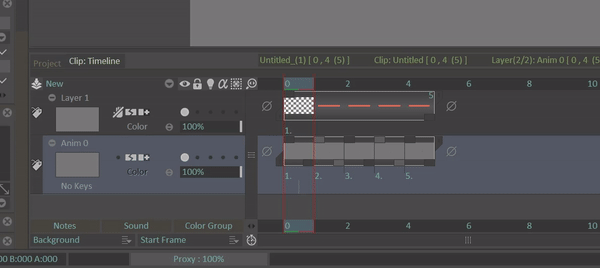

Problem 1:
Layer 1
A layer solely consisting of an EMPTY image set to an exposure greater than 1 is NOT identified as an empty layer. But if you break the extended image into separate empty images, it will be identified as an empty layer.
Click on image for the gif

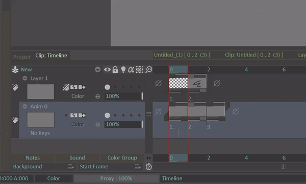

Issue 2:
Layer 1's first image is empty but the second is not. Yet it is still identified as an Empty Layer.
