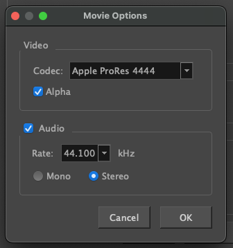

I have noticed the same thing. I have wondered if it had something to do with the FFMpeg ProRes 4444 codec that TVPaint now uses instead of the Apple ProRes 4444 codec. FFMpeg ProRes is not exactly the same as Apple ProRes in Quicktime (which allowed the option of Millions of Colors+.) Although we are often told "Quicktime is dead" it seems some applications such as Adobe AfterEffects and Toonboom Harmony continue to use Apple ProRes Quicktime codecs, which seem to have more consistent results than FFMpeg ProRes in terms of color fidelity.

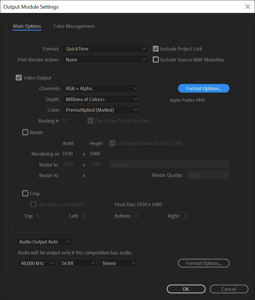

After Effects: Option of setting color depth to Millions of Colors+ is still available: https://docs.toonboom.com/help/harmony- ... macos.html

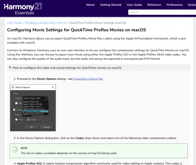

Toonboom Harmony export options with ProRes codecs does not show the option of setting color depth to Millions of Colors+ , but it does use the original Apple ProRes codecs , not FFMpeg -

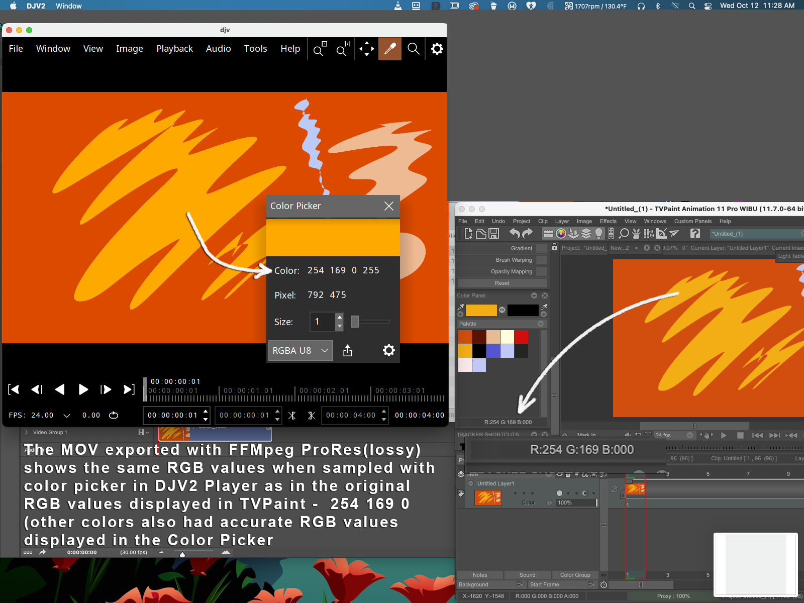

I ran a few tests just now to confirm what I'm seeing. With FFMpeg ProRes I definitely see a color shift ; the colors in the exported .MOV file are lighter, not as saturated or vibrant. I confirmed this by loading the .MOV file in Photoshop and After Effects, then using the eyedropper tool to sample various colors. The RGB values are different in the .MOV (exported with FFMpeg ProRes) than in TVPaint.
However, when I switched to using FFMpeg PNG (Lossless) codec the colors in the exported .MOV retain the same RGB values as the original colors in TVPaint, although as displayed in TVPaint my perception is that the colors in TVPaint look a bit more saturated/vibrant than in the exported .MOV file (both with FFMpeg PNG Lossless and FFMpeg ProRes, so this may be a display issue in TVPaint or it's a problem with the color space calibration of my monitor. (?) My experience with Apple ProRes 4444 is that it had better color fidelity than FFMpeg ProRes 4444 . I wish it was possible for Mac users of TVPaint to still use Apple ProRes codecs using the Apple AVFoundation framework, which is pre-installed with macOS. (or perhaps some additional tweaking could be done with FFMpeg ProRes?)

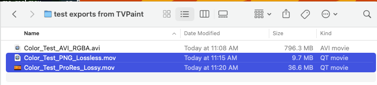

Export in AVI RGBA mode produces excellent color fidelity, but the file sizes are HUGE compared with FFMpeg MOV ProRes (lossy) or FFMpeg MOV PNG (lossless).
Surprisingly the file size of FFMpeg ProRes (lossy) is significantly larger (36.6 MB) than the FFMpeg PNG (lossless) file (9.7MB).
This is odd , because as I understand it , the intention of ProRes is to produce high-quality video at a lower file size to facilitate editing without getting bogged down with very
large files sizes. So I would think ProRes (lossy) files should be smaller than PNG Lossless files.

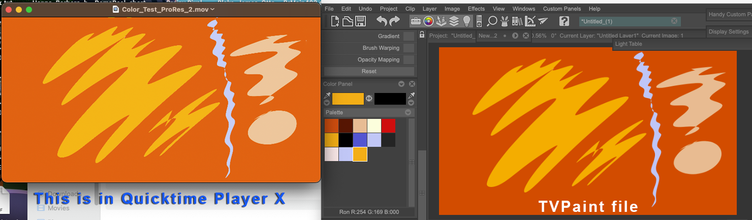

Also, it seems to make a difference depending on what video player is used to view the exported MOV file. Quicktime Player X will not open FFMpeg PNG (lossless) at all. However,when Quicktime Player X opens FFMpeg ProRes (lossy) the colors look dull and washed out. BUT ... when I open the same FFMpeg ProRes (lossy) file in DJV2 Video Player the colors look vibrant and saturated, the same as in TVPaint. In fact, using the Color Picker in DJV2 Player it shows that the RGB values of the FFMpeg ProRes MOV file match the RGB values of the color palette in the original TVPaint file. (in fact , to my eye the colors look a tad more vibrant in DJV2 PLayer than in the original TVPaint file, but the Color Picker says they are the same RGB values.
Compare to how washed-out the FFMpeg ProRes file looks when opened in Quicktime Player X alongside the original TVPaint file.
(click on image to view larger)
So, the video player you use to view the exported MOV file definitely makes a difference. FFMpeg ProRes files in Quicktime Player X look dull and washed out , but the same FFMpeg ProRes files in DJV2 Player look vibrant and saturated . VLC Player also has vibrant/saturated colors when playing back FFMpeg PNG (lossless) , but VLC will not open FFMpeg ProRes (lossy) files exported from TVPaint.
