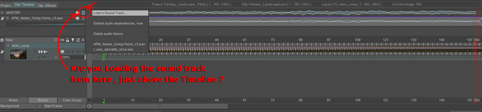

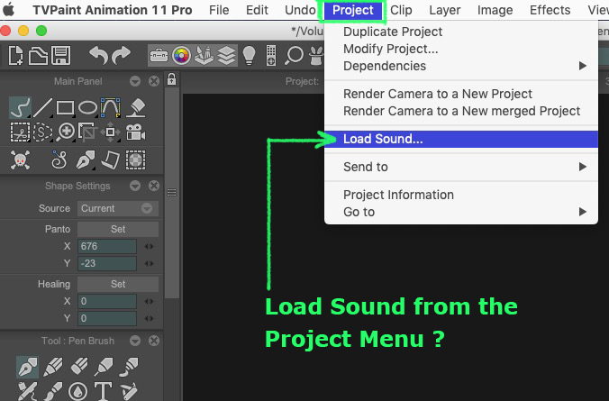

Could you post some screen shots of what your TVPaint interface with the soundtrack loaded looks like ? Maybe I can help you.
Where are you loading the sound from ? From the Project Menu or from the Load a Soundtrack button just above the Timeline ?
Have a look at the user manual - https://www.tvpaint.com/doc/tvp11/index ... -add-audio
and this video: https://www.youtube.com/watch?v=F9YPERoRcps
Loading from the Project Menu ? -
Or from the Timeline button for "Load a Soundtrack" ? -
(click image to view larger)

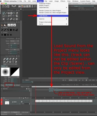

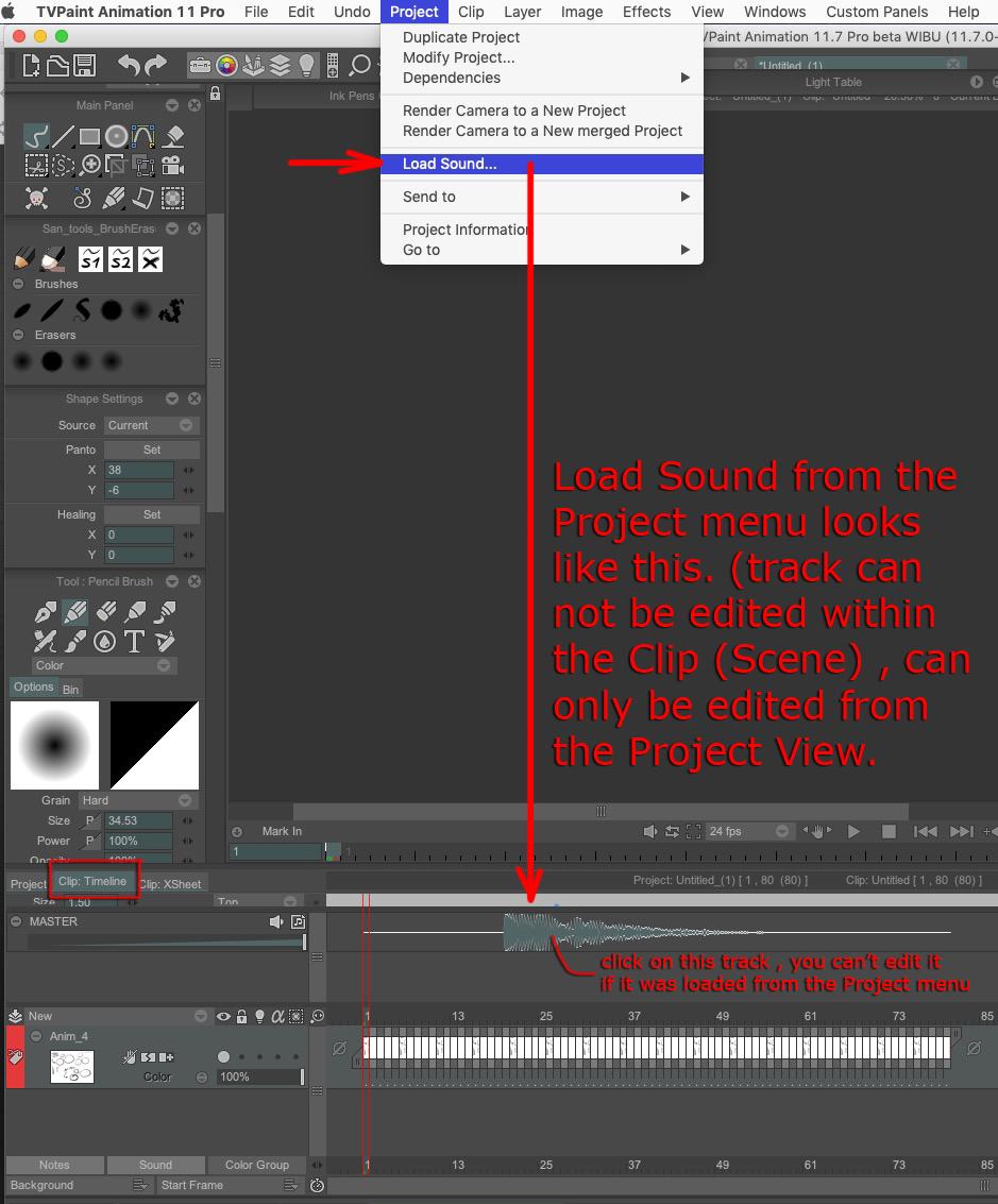

kabecio wrote: 19 Apr 2022, 23:14 As far as LOAD SOUND goes - does it truly matter which place you select it from ?
There is a difference. One way is loading a soundtrack that is a Master Track which spans the entire Project.
The other way is for loading soundtracks that are for specific Clips.
See screenshots:

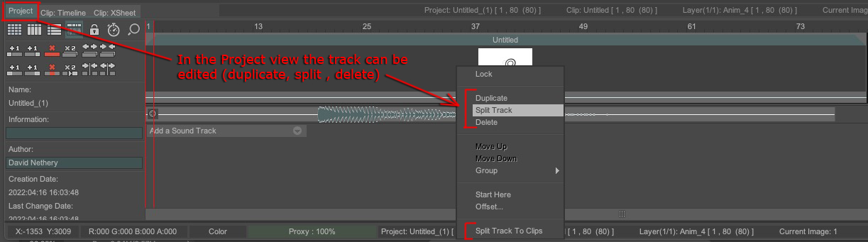

If you load sound from the Project menu , the soundtrack can only be edited within the Project View , not in the Clip View:

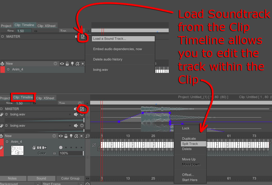

But if you load sound from the little icon in the Clip Timeline view it allows you to edit the soundtrack (Duplicate, Split, Delete track) from within the Clip.
