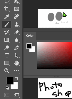

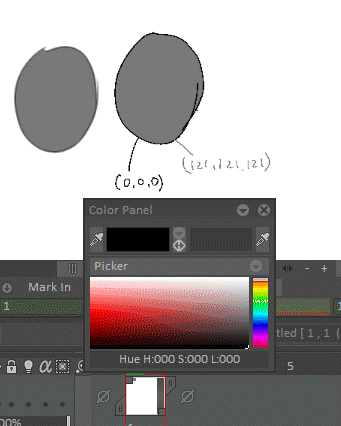

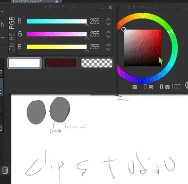

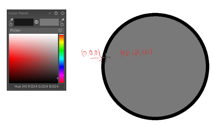

for example,
in this img, there is only black(0,0,0) and grey(121,121,121)
no Anti-Aliasing, but with tvp interpolation, color picker is picking non exist color like (253,253,253) (52,52,52)
in tvp
photoshop
clip studio
e-mail : ini@7ini.com twitter : @Ain_is_

ini wrote: 26 Nov 2022, 04:41 for example,
in tvp
photoshop
clip studio
Hello ini,
I've run some tests on my side and I did manage to reproduce it:
My project's dimensions are 2560x1440, and I was at 78,5% zoom ratio, but I was able to have the issue with 103% zoom ratio.
It won't be fixed for next release (hopefully next week) but we'll see what we can do for the next one.
