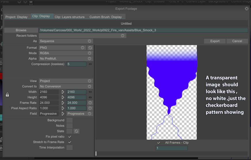

In your screenshot the image shows in the export window with a white background. If it has a white background then it's not a transparent image.
When you export in RGBA mode and there is no background then it should look like this, with just a checkerboard pattern visible behind the image.
Here are my export settings -
Screen Shot 2022-11-22 at 7.10.19 PM.png (68.59 KiB) Viewed 3002 times

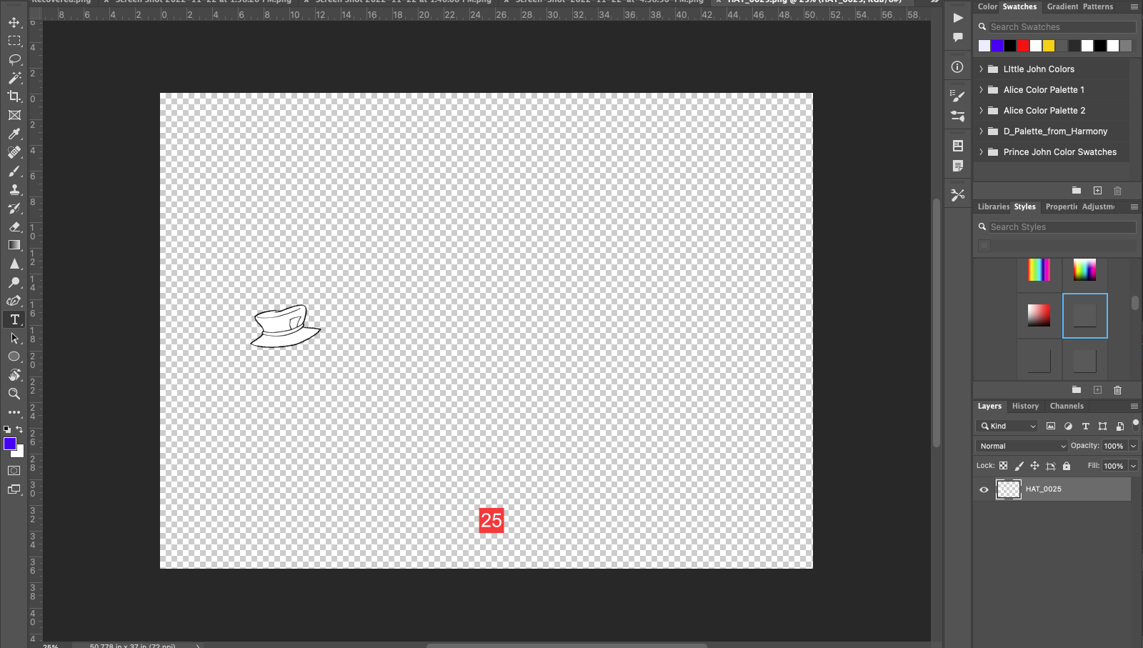

Here is how this image appears when I open it in Photoshop:

D.T. Nethery wrote: 23 Nov 2022, 00:06 In your screenshot the image shows in the export window with a white background. If it has a white background then it's not a transparent image.
TY- I'm an id**t. Upon further review- someone didn't export with alpha long ago.
