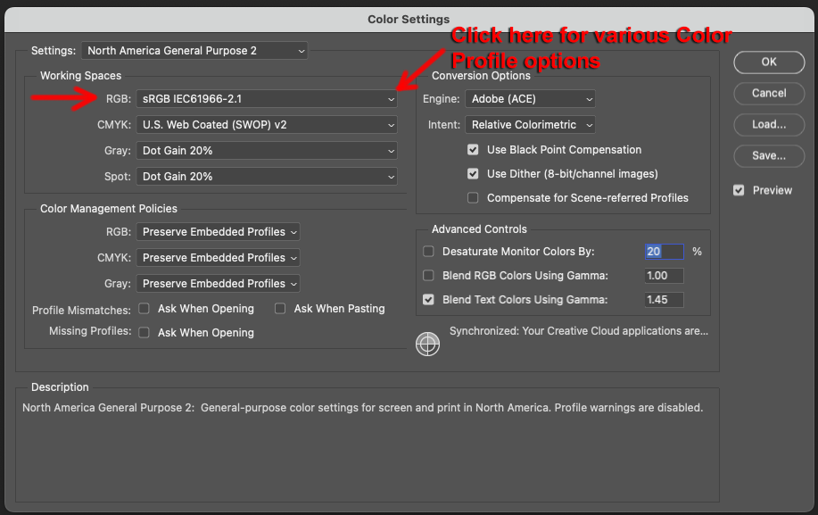

I don't know the options you have in Photoshop Elements, but in Photoshop you can change the Color Profile by going to Edit > Color Settings.
Screen Shot 2022-12-14 at 8.49.38 AM.png (85.5 KiB) Viewed 1417 times
Then in the Color Settings under Working Spaces, click on RGB to set the RGB color profile. The settings shown in the screencapture are the settings in my Photoshop. This works for me to export PNGs from Photoshop that will open in TVPaint with no problem. Experiment with different Color Profile options available in the RGB menu until you find one that works for you.

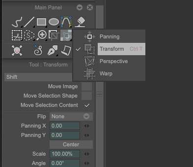

Simon W Edmondson wrote: 14 Dec 2022, 12:34 2.However, when I tried to scale that file on the layer, the scale option could not be accessed only the pan and crop.
Then rescaled the image in Photoshop, saved as psd, and imported as new layer.
When you say "scale option" , do you mean the Transform Tool in the main panel ? I can not think why that would not work to let you scale your selected layer. Can you post a screenshot showing what you are trying to do ?

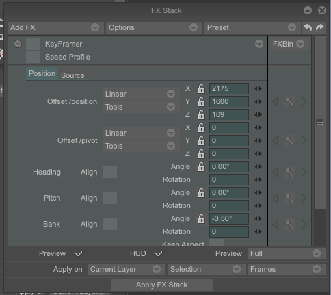

Another option for scaling would be to use the Keyframer tool in the FX Stack , adjusting the Z axis coordinates to scale the image up or down.

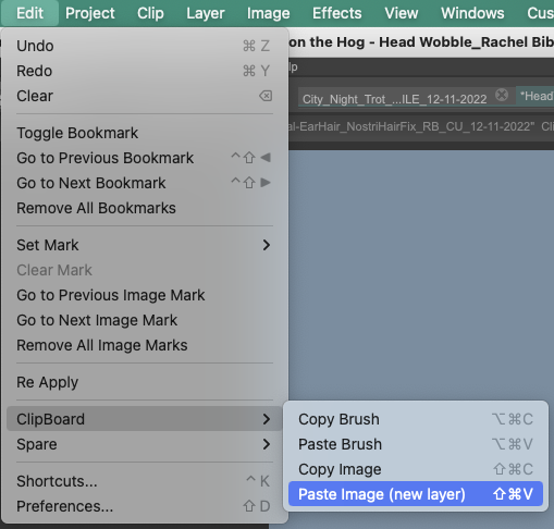

Simon W Edmondson wrote: 14 Dec 2022, 12:34 3. when I then tried to import another psd file as a new layer into the same project. The file imported but, set it up as a new project, rather than as a new layer within the same project?
Yes, the same happens for me when I import a PSD file into TVPaint . It opens it up as a new project. I don't know how to change that.
Here's a workaround: with your layer open in Photoshop (as a transparent image, no background) use the marquee tool to select the entire image , Copy (Cmd C on Mac or Ctrl C on Windows ), then go to your TVPaint project and go to Edit > Clipboard > Paste Image (New Layer).

The scaling problem is down to operator error on my part. When using TVP before all the updating was set to go to scale immediately, and in my hurry, I didn't see the other options. My mistake.
