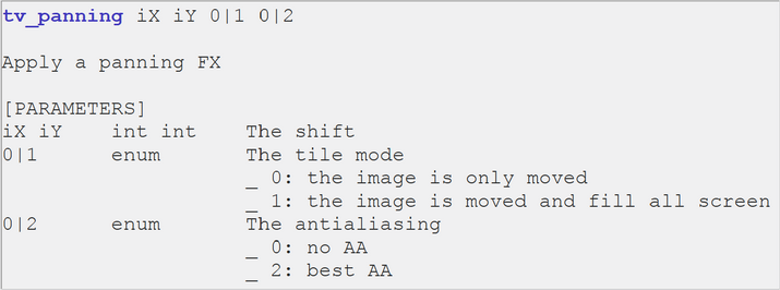

FROM THE GEORGE SYNTAX DOCUMENTATION:
In a custom panel, I start out by creating eight buttons, each named as below with one of the following embedded, single line scripts:
button-names (tv_panning iX iY 0|1 0|2)
Shift+Left tv_panning -1 0 1 2
Shift+Right tv_panning 1 0 1 2
Shift+Up tv_panning 0 -1 1 2
Shift+Down tv_Panning 0 1 1 2
10 Pixels:
Control+Left tv_panning -10 0 1 2
Control+Right tv_panning 10 0 1 2
Control+Up tv_Panning 0 -10 1 2
Control+Down tv_Panning 0 10 1 2
Then, in shortcut keys, under my custom panel name, I assigned each shortcut key-combo to the custom button with the appropriate matching name in the custom panel.
Notice I set all tile-mode values to 1 so that the moved image will fill the screen, i.e.wrap around)

For a long time now I've had my 4-shift and 4-control directional keys (up, down, left, right) setup for the purpose of moving the image exactly a single pixel or 10 pixels in all directions using the tv_panning command in GEORGE.In a custom panel, I start out by creating eight buttons, each named as below with one of the following embedded, single line scripts:
10 Pixels:
Sven
EDIT: I'm uploading a version of the Panning Panel for anyone one who wants to try it...
