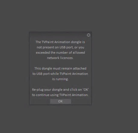

I tested this on two system,
both windows 10, 64bit.
11.7.0 and more previous version is running normally,
but only 11.7.1 vesion of donggle version is not running.
I was using 11.7.0 or previous version,
I backed-up the 11.7.0,
and then, set the 11.7.1 version up, It's not working,
Tvp can't find the donggle.
*reinstalled sentinel protection, but the situation is same.
Second system was my new notebook, which was not installed the TVP ever.
I installed 11.7.1 first, for the check, not working.
but after that, I set the previous version 11.7.0 up, It's working.
but still, 11.7.1 is not working.
If there is someone using the donggle version,
I hope some comment, about if you could run the recent version or not.

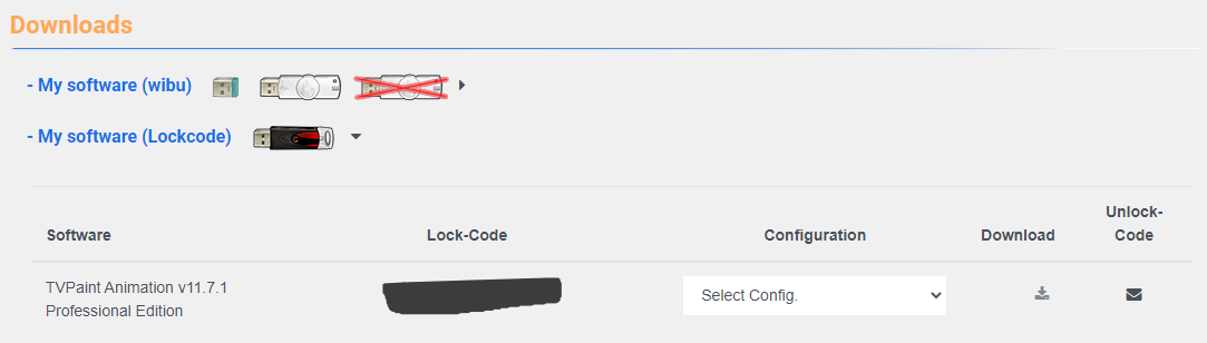

the tvp I downloaded, was in here,
Am I downloaded correct one?
When I see the without donggle version above it, there is some difference on letters,
above one is with phrase like '(last update on December 7th,2022)'
and donggle version is not have them.
and It seems dongleless version in my other system is working correctly.

Ini, apparently a faulty build was still available for download in your profile. I recommend you redownload and reinstall TVPaint from your user account and the issue should be fixed.

Dean wrote: 23 Dec 2022, 14:52 Ini, apparently a faulty build was still available for download in your profile. I recommend you redownload and reinstall TVPaint from your user account and the issue should be fixed.
Tried just right now what you said, but unfortunately, It's same as previous....
