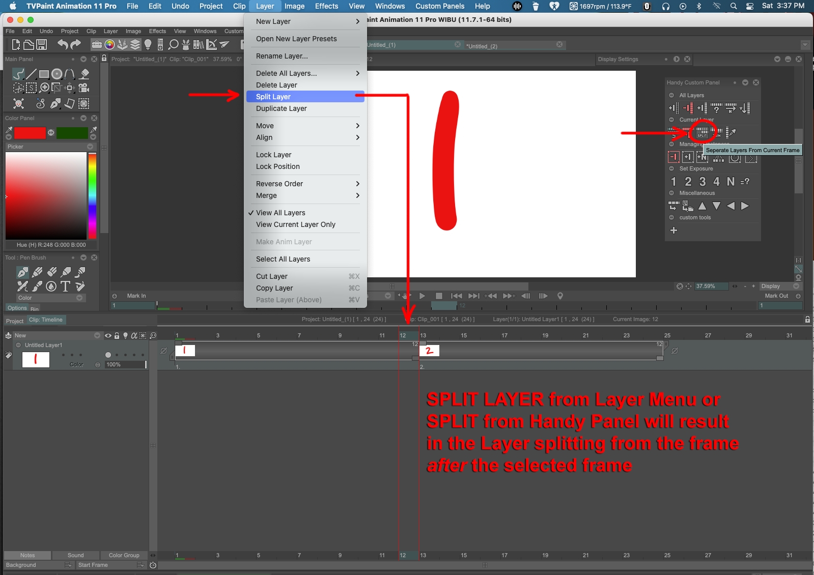

SPLIT Layer command (from the Handy Panel and also from the Layer Menu) splits to the frame after the selected frame. So , for example if I have a layer that is 24 frames long and I split it at frame 12, the result is an even split, so the first layer has 12 frames and the second layer has 12 frames.

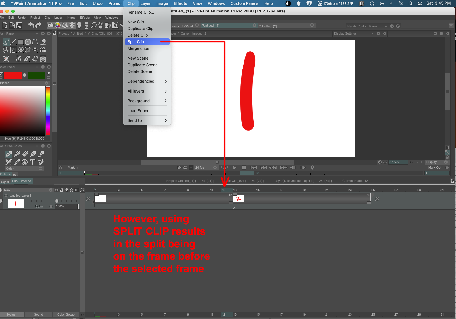

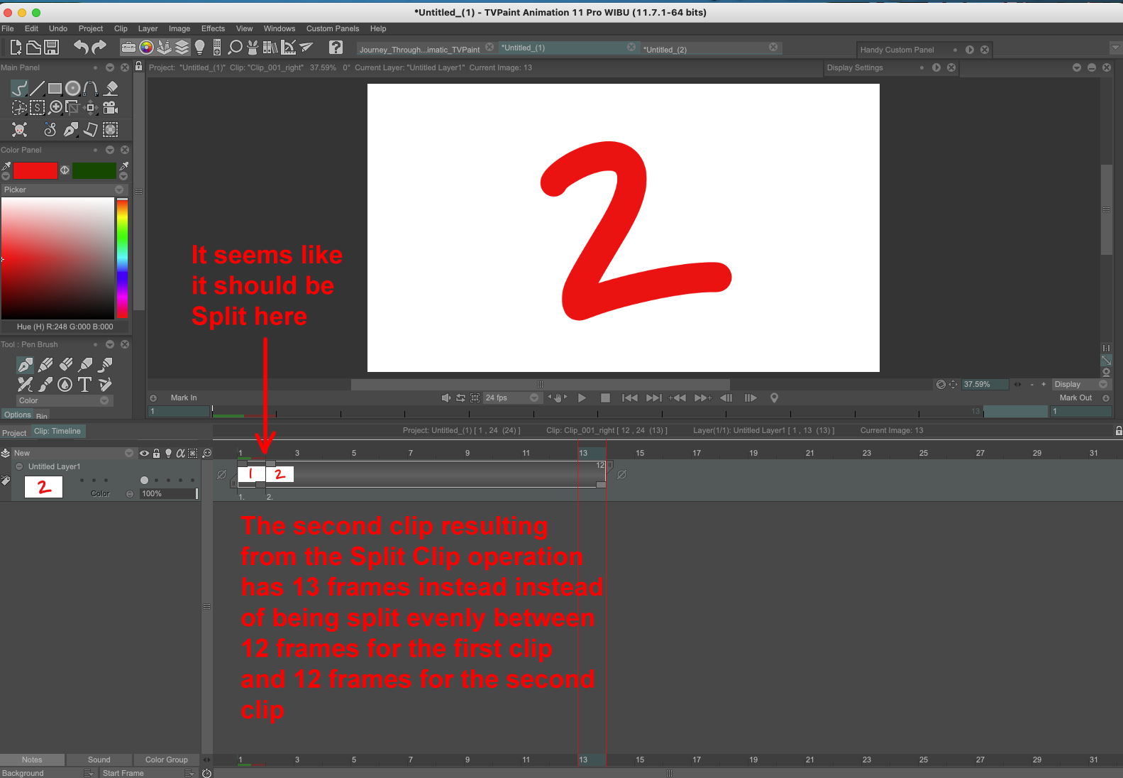

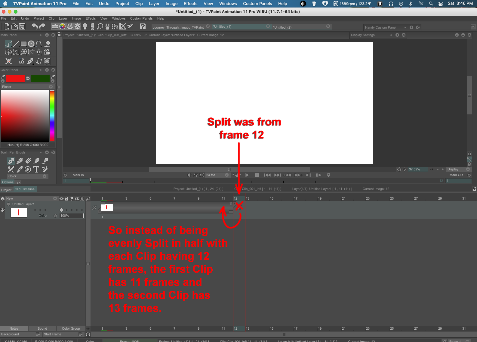

However, SPLIT Clip command (from the Clip Menu) behaves differently in that it will split to the frame before the selected frame. So if I am on frame 12 when I click on SPLIT Clip , it splits to the frame before , so the first clip (Clip 001_left) has 11 frames and the second clip (Clip_001_right) has 13 frames , instead of an even split of 12 frames and 12 frames , like the SPLIT Layer command.
Of course , it's not a terrible burden to have to remember that the two similarly named functions (SPLIT Layer and SPLIT Clip) behave differently in how they apply the Split (after or before), so if I am splitting the Clip and want it to be an even split I have to remember to move the cursor ahead one frame to frame 13, so when it splits the clip it will split it at frame 12 , resulting in an even split of 12 and 12. But it seems like this Splitting behavior should be consistent, whether the user is splitting a layer or splitting a clip, so no mental shift is required. Every time the user invokes a Split command (whether it is to Split a layer or a clip) the user knows that the split will be after the selected frame.

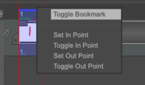

I don't know how to quickly split a layer into multiple clips to print out for a storyboard , only the usual way of Split Clip (x 50 ) , but a workaround could be to use Bookmarks.Peter Wassink wrote: ↑07 May 2025, 08:18 And finally a question regarding splitting.
Is there an easy way to split a layer with, say 50 frames, into 50 clips? (to print out a storyboard)

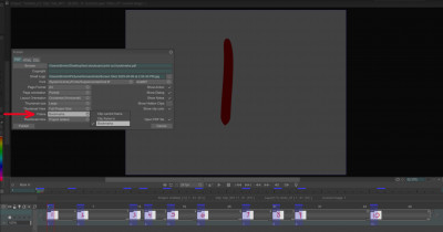

Let's say we have 50 storyboard panels drawn sequentially on a single layer (but exposed for different lengths of time for the purposes of the animatic). Bookmark the first occurrence of each storyboard panel (intance). If you have a keyboard shortcut for Add Bookmark , plus a shortcut set to jump between instances , you can quickly navigate from one panel to the next , hit the shortcut to Add Bookmark, then quickly jump to the next instance, Add Bookmark, etc. Then when you go to Publish , select Frame - Bookmarks.
The limitation of this workaround is if you have Action, Dialog, Notes selected in the Publish settings, it only adds the boxes for Action, Dialog, and Notes to the first panel.
I didn't do 50 panels, but here it is illustrated with 10 panels. Each panel is bookmarked. The Publish settings are set to publish the Bookmarked frames.
By the way, TVPaint Developers, please add the command Clear All Bookmarks to the little pop-up menu for Toggle Bookmark . There is a shortcut command to Clear All Bookmarks that can be assigned to any key , but I think Clear All Bookmarks should also be in that pop-up menu. Even better would be an additional command in the menu for Clear Selected Bookmarks, if you only want to clear a certain section of bookmarks , but not clear all bookmarks.
