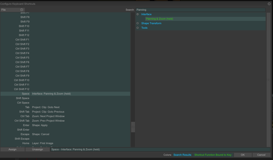

I must have missed it before , but am pleased to find that this feature request was added to one of the 11.7.1 hotfix updates.
Now there is a new Keyboard Shortcut called Panning & Zoom (held). Just assign it to the Spacebar and now you can Pan/Move by holding down spacebar, just like in Photoshop, Harmony, Clip Studio Paint, OpenToonz, etc. (and for those who prefer to use Alt key for Pan/Move , the Alt key still works for this purpose).
Screen Shot 2023-11-01 at 9.28.17 AM.png (84.24 KiB) Viewed 24041 times
