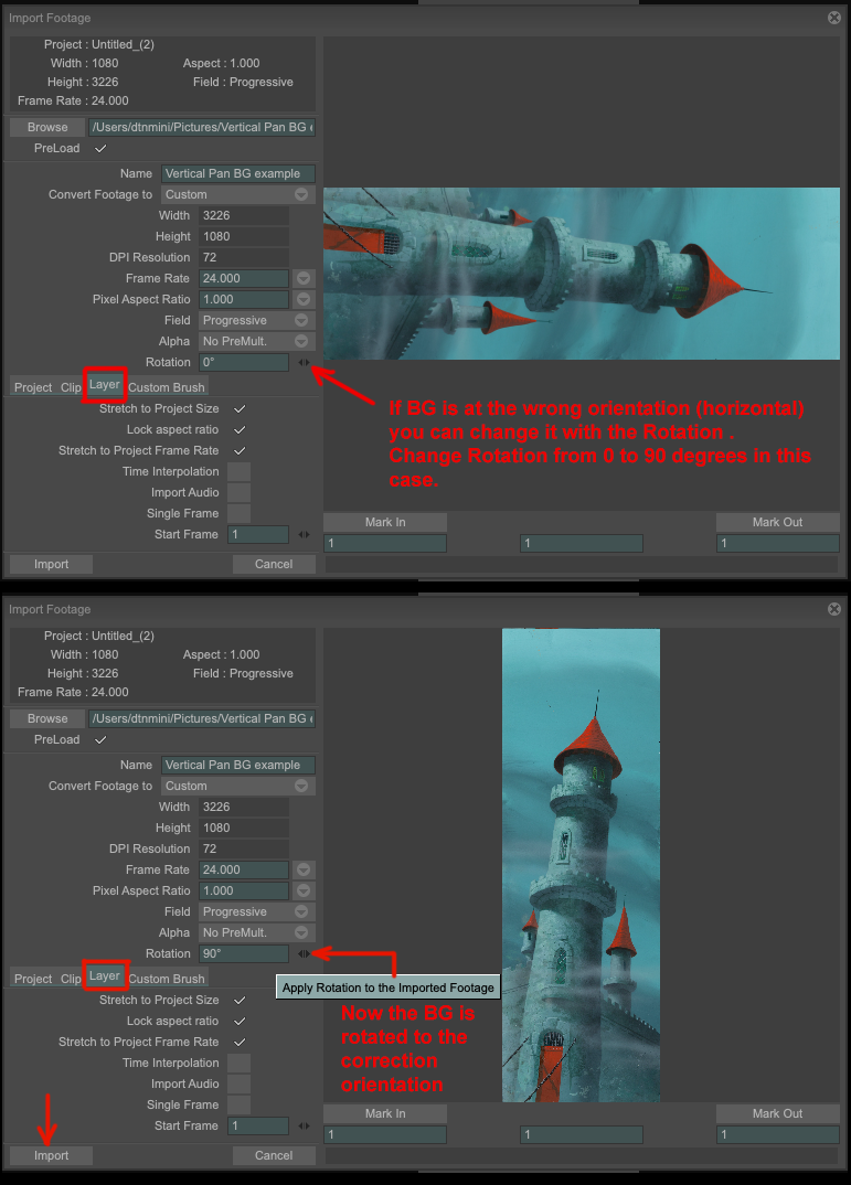

Also, it imports on it's side as a horizontal image.
In the import window you can change the orientation to make it vertical again.
Use ROTATION to reorient the BG from horizontal to vertical -

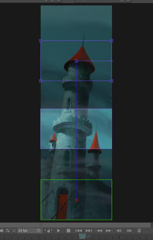

Set the camera move:

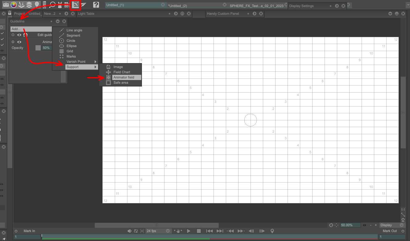

Did you find the Field Guide in TVPaint yet ? It's in the Guidelines .

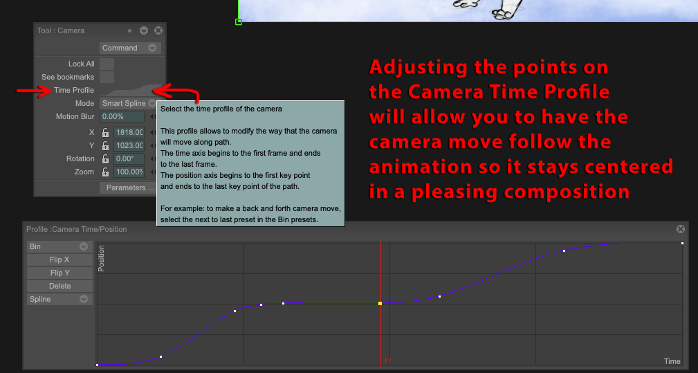

I'm still trying to visualize what you're trying to do with adjusting the existing animation to the camera move fielding ? Do the drawings need to be resized ? (try the KeyFramer tool in the FX stack) Or is it that the camera fielding is not keeping the animation centered in the composition ? In the latter case, just re-adjust the camera move with the Camera Time Profile editor.
TVPaint Camera Time Profile Curve.png (88.54 KiB) Viewed 4708 times

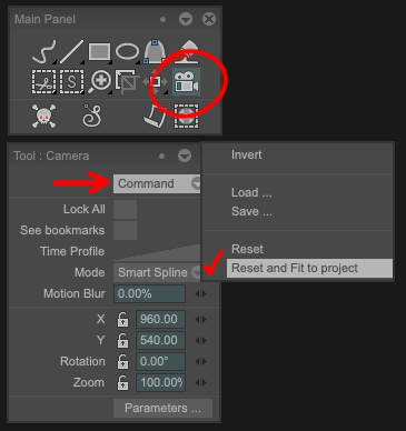

Or reset the camera and start over by recreating the camera move.
