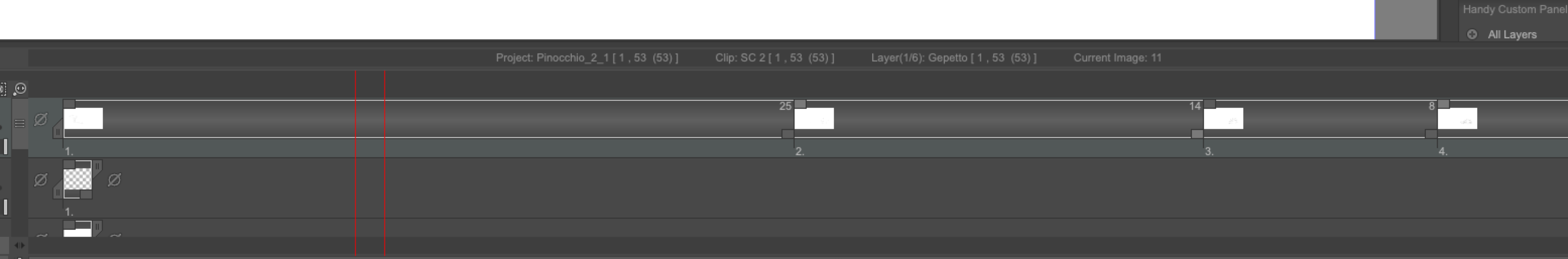

The frame count at the top of my timeline has mysteriously disappeared. This is the case for scenes in one of my projects, but when I open another recent project, the numbers are there. If I open preferences, the numbers immediately reappear. Then when I click on the other scene, and go back, the numbers are gone again. Any idea what is causing this?

When I put an end point to the scene the problem disappeared. It still means I had to make an instance to the length I wanted for the scene, just so I could find the spot for the end point. So that's the minor workaround.

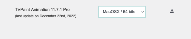

That was a bug in 11.7 which was fixed in 11.7.1 . Make sure your software is updated to version 11.7.1 (released on Dec. 22,2022).
Screen Shot 2023-02-12 at 7.54.49 AM.png (14.43 KiB) Viewed 1979 times
You can check the version number under the Help Menu > About TVPaint Animation
