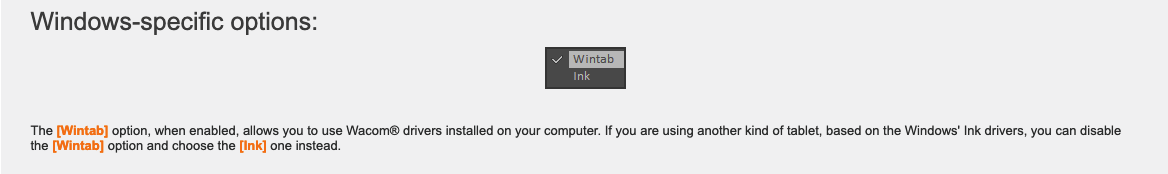

I'm on Mac, not Windows, but I recall reading that in TVPaint Windows version there is a setting in Preferences called WinTab. Maybe WinTab works better than Ink ? Give it a try.
Screen Shot 2023-02-12 at 4.00.11 PM.png (31.24 KiB) Viewed 1895 times
https://www.tvpaint.com/doc/tvp11/index ... es-general

switching between the two resulted in the exact same problems unfortunatelly

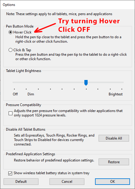

In your Wacom pen settings - Options , is Hover Click enabled ? Try turning it off.
Does that help ?
Wacom Hover Click.png (19 KiB) Viewed 1882 times
