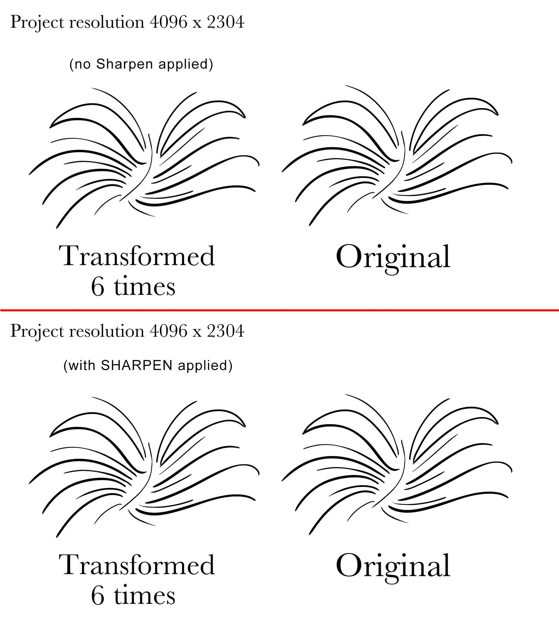

Just to clarify, the image of the cube used in my video to demonstrate the Sharpen mode is a bitmap image , not vector. The Sharpen mode will work on any line art drawn in TVPaint. (but like most any fix that is applied after the fact , it has it's limits to how much it can restore a very blurred image). I hope it works for your purposes.
What size are you working at in your original project ? I have found that working at least 2x over my intended output helps. (so for 1920 x 1080, work at 3840 x 2160, or higher).

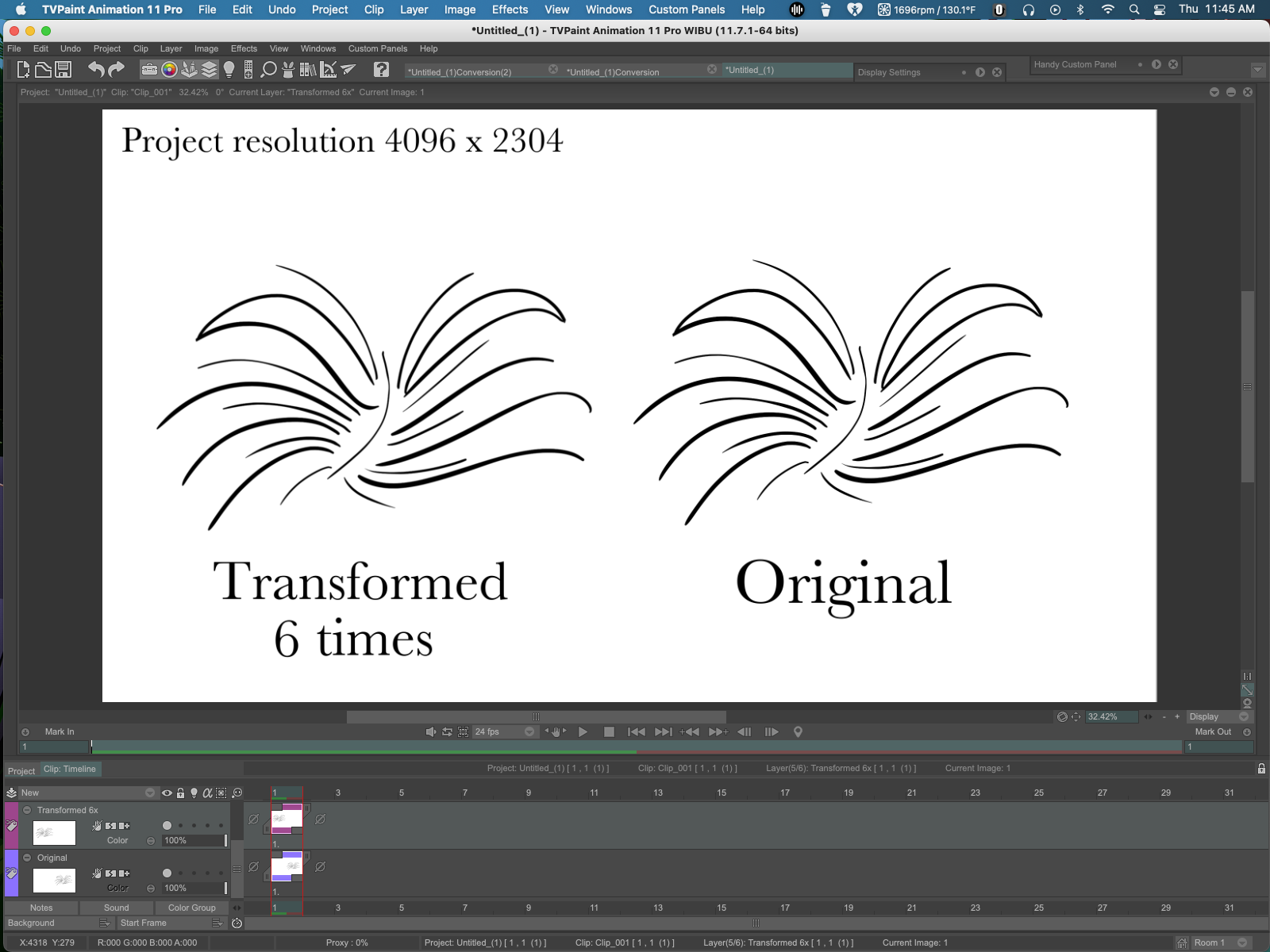

I'll try to demonstrate with these three sets of screen captures. First I drew an image at 4K resolution (4096 x 2304). I made a duplicate of that image so I have two identical images side by side. The one on the right will remain unaltered. The one on the left will be transformed (rotated) 6 times. BEFORE I did anything to the image I duplicated the project (modified size) so I had the same images in a project at 1920 x 1080 resolution and 1280 x 720 resolution. In each of these three projects I will apply the same transformations to the duplicate image on the left, then we can compare them below.
Here is the original image (on the right) compared to the transformed image (on the left) at 4096 x 2304:
(first image shows screen capture of the TVPaint interface after the transformation) (second image shows the exported image) (Click on the images to view them full size. At full size it is easier to see the effects of the transformation)

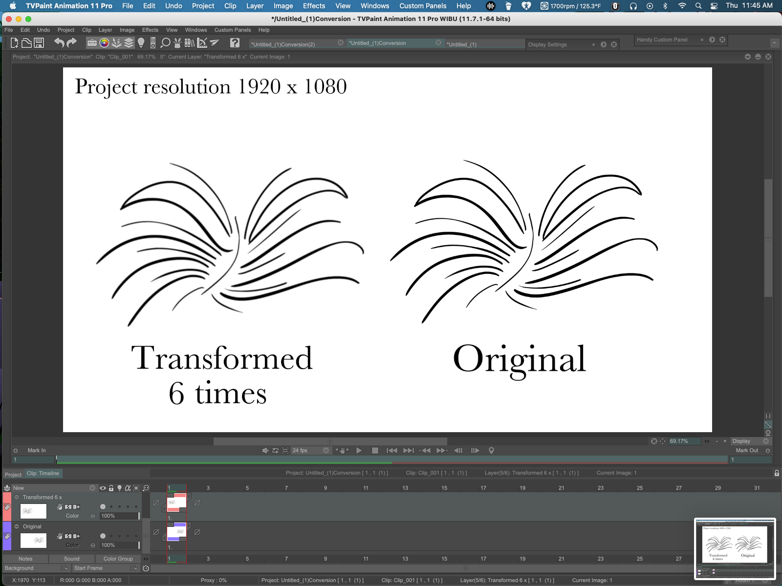

Now here is the same number of transformations applied to the same image at 1920 x 1080:
(results seen within TVPaint interface) (exported image)

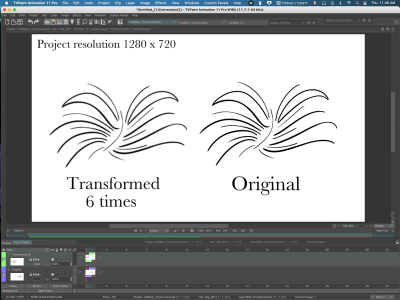

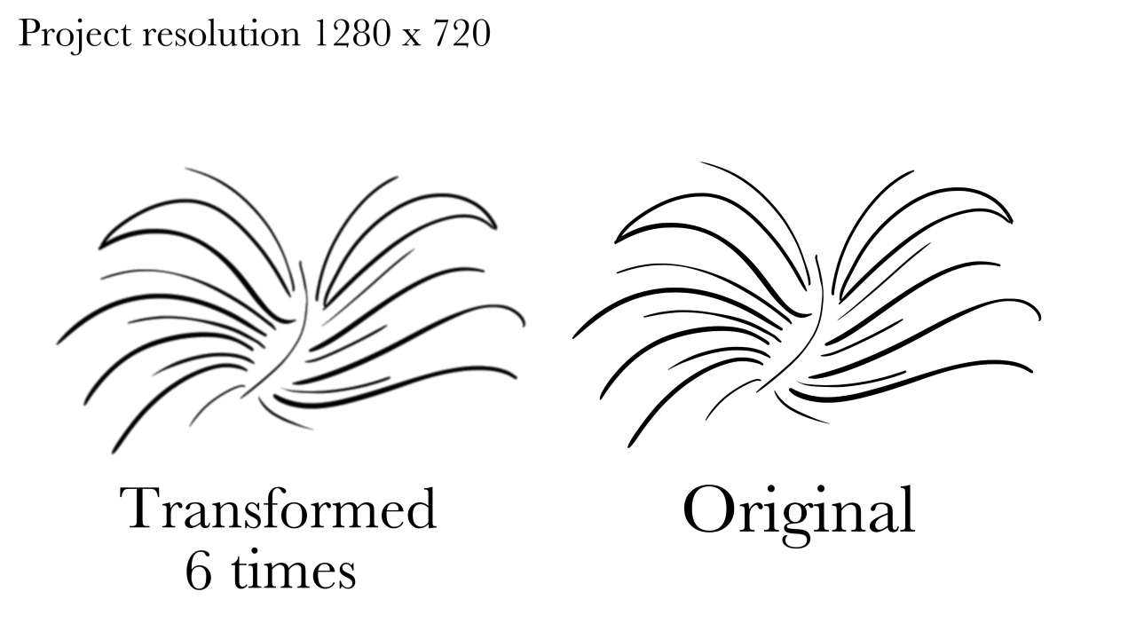

Finally, here are the results of the same number of transformation applied to the same image at 1280 x 720:
(results seen within the TVPaint inteface) (exported image)

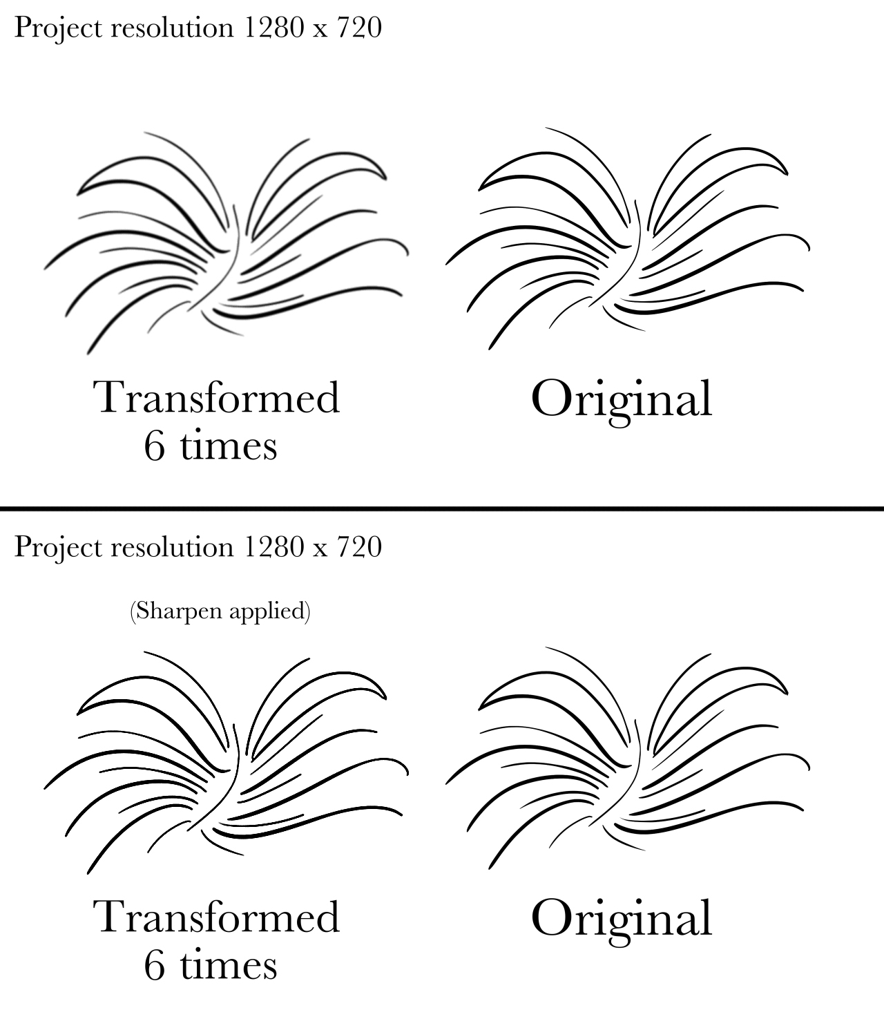

By comparing them all, you can see that the transformations done on the images at resolution 1920 x 1080 and 1280 x720 are more obviously degraded.
Here is the version at 4096 x 2304 comparing it with no sharpening applied and with sharpening applied:
(again, click on the image to view it full size to better see the results of the sharpening)
Now here is the worst result (1280 x 720) with Sharpen Mode applied:
