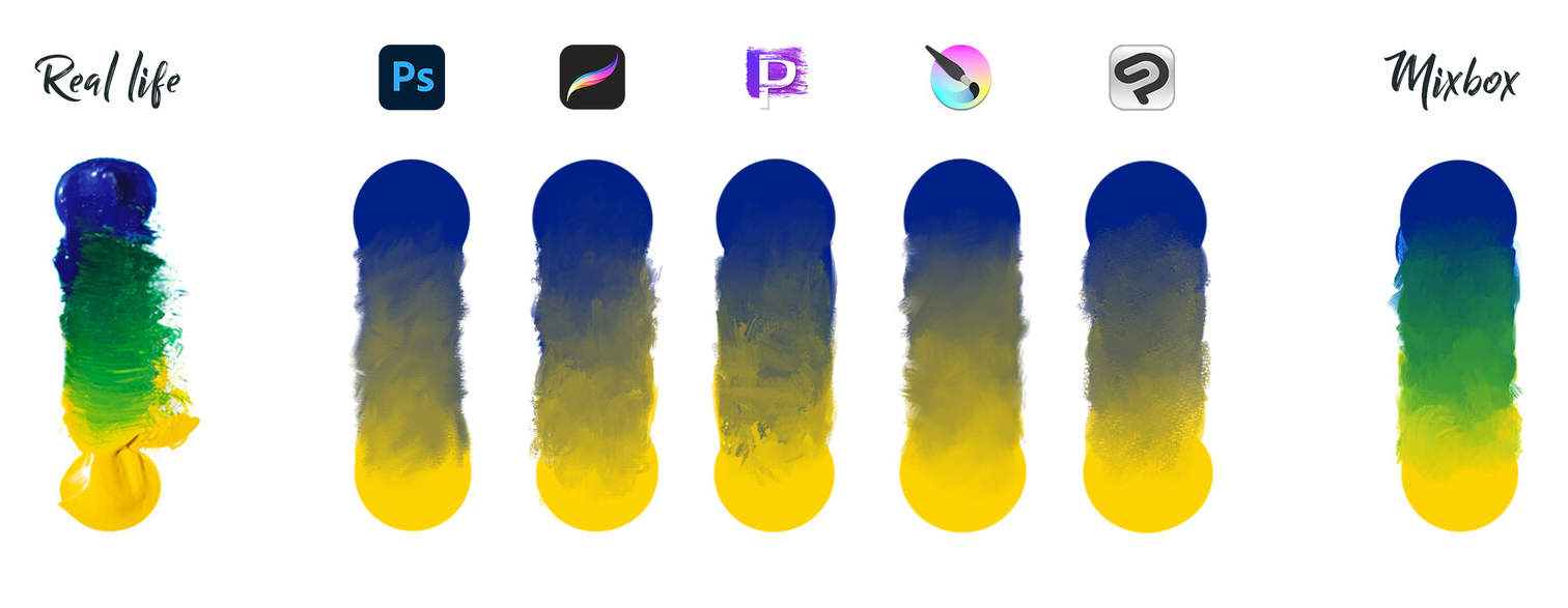

btw the makers of another software that this man was involved with (ebsynth) have something very interesting.
i just discovered it and its very Very interesting, an entirely new way of colormixing.
They have created the only software that mixes color like real media..!
mixbox
It would be am awesome feat if this could somehow also be introduced in TVPaint.
