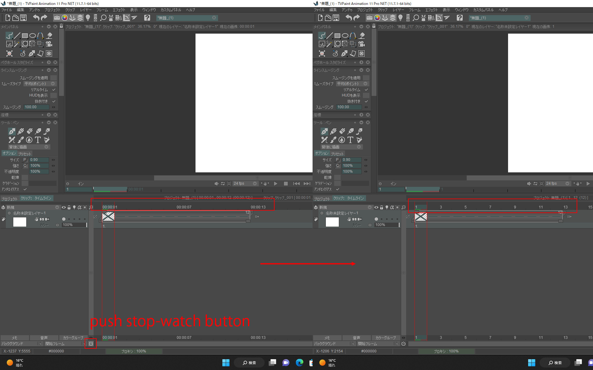

Hey,
I know this should be an option but I can't find it:
I would like to show the frame number in the timeline in stead of the time code. How do I switch?
Now I only see the first 12 frames (in a 12fps project) and after that it says 1:01, 1:02 and so on, but I would like to see 13,14,15 in stead of 1:01, 1:02, 1:03...
Thanks!
TVP Pro 11.7.1

Please check the attached image.
Hope it helps you.

Yes! Thanks a lot!
That was exactly what I meant.
