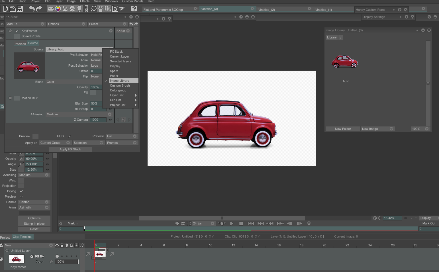

This is how we can do it now:
Open FX Stack > Keyframer. Set Source of Keyframer as Image Library, select the image from the Library, then click Apply FX Stack to get the image into a layer.

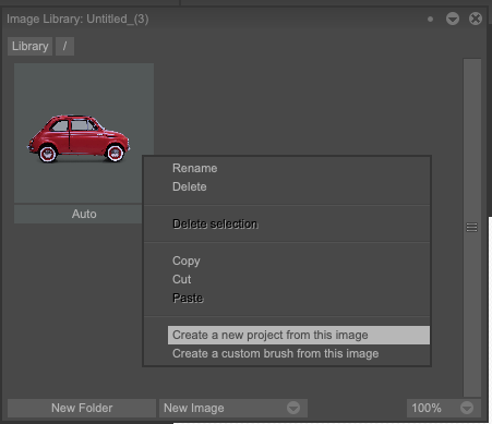

OR click on the image in the library and select "Create New Project from Image".
Screen Shot 2023-04-01 at 1.14.46 PM.png (32.33 KiB) Viewed 7675 times
But it seems that a simple Copy and Paste function should be doable. As it is now I can Copy an image from the library and Paste it into another Image Library in a different Project , but I hope it would be possible to simply Copy the image from the library and paste it into a layer in the same project. (?)

Another way of doing it is to create a custom brush from the image and apply it in the drawing area.
That has the advantage of letting you position the image where you want it to be.

Thierry wrote: 03 Apr 2023, 09:21 Another way of doing it is to create a custom brush from the image and apply it in the drawing area.
Thank you for reminding me. I completely forgot about this option in the Image Library (even though it was right there for me to see).

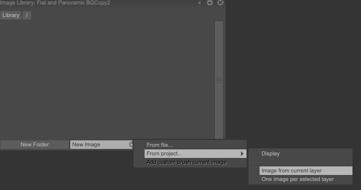

Would another option be possible to simply REVERSE the process where an image from a layer is added to the Image Library ? As it is now if we select a layer we have the option to add an image to the library from a selected layer.
Screen Shot 2023-04-04 at 9.44.34 AM.png (23.39 KiB) Viewed 7530 times
Can it be reversed to add selected image from Image Library to a layer in the project ?
Screen Shot 2023-04-04 at 9.46.33 AM.png (28.12 KiB) Viewed 7530 times

That's more or less what Guillaume and I had in mind to solve the initial problem (with a message warning the user if the image is too big) :)
