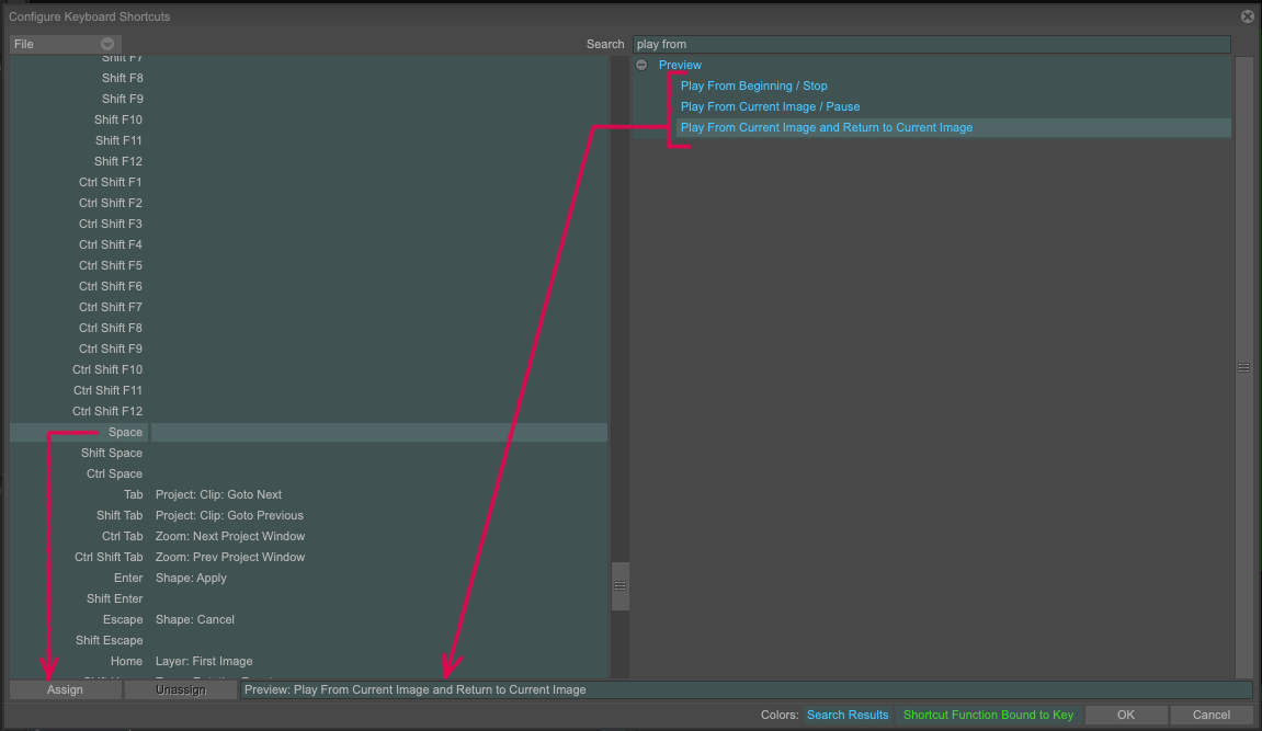

I tried hitting the spacebar , but nothing happened.Peter Wassink wrote: ↑02 Apr 2023, 11:03 The spacebar is set to always play "from current Image/pause."
did you try that?
I checked Preferences on my TVPaint (version 11.7.1) and the Spacebar is not set to "Play from Current Image/Pause". Spacebar was actually unassigned. I don't know if that's a change in default keyboard shortcuts in 11.7.1 or something I did by messing around with the keyboard shortcuts at some point.
Anyway,I thought I'd mention it for the benefit of TVPUSER and others who might wonder why the spacebar doesn't seem to do anything. Double-check that it's set to "Play from Current Image/Pause" or the other options "Play From Current Image and Return to Current Image" or "Play from Beginning/Stop" .
However, I notice that there seems to be no difference between the behavior of "Play from Current Image/Pause" and "Play From Current Image and Return to Current Image" . With "Play from Current Image/Pause" there is no Pause , it just continually plays , returning to the current image and plays again until I hit the spacebar again. I guess it is supposed to pause between playbacks ,but the pause doesn't seem to be working.

Hello everyone, regarding the difference in Spacebar bindings among users, this could be due to remnants of previous versions contained in older config files.

I have no problem binding the keyboard shortcuts "Play from Current Image/Pause" or "Play From Current Image and Return to Current Image" or "Play from Beginning/Stop" to the Spacebar, but the problem I notice with "Play from Current Image/Pause" is that there is no Pause , it just continually plays , returning to the current image and plays again over and over, until I press the spacebar again. I would expect that there should be a pause between playbacks , but the pause doesn't seem to be working. It is the same with "Play from Beginning/Stop" ... it does not stop. It simply repeats over and over until I press the spacebar again.Dean wrote: ↑11 Apr 2023, 08:00 Hello everyone, regarding the difference in Spacebar bindings among users, this could be due to remnants of previous versions contained in older config files.
I also agree that the spacebar Play behavior needs a overhaul. Thierry will be back at the office in 2 days and I will talk to him about this.
