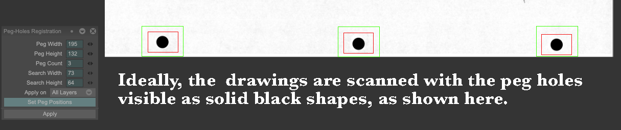

In the past I've always recommended placing a strip of black electrician's tape along the path where the peg holes pass over the scanner, which causes the peg hole shapes to be scanned in solid black. This is makes it very easy for TVPaint's Peg Holes Registration tool to find the peg hole shapes and register them in tight alignment, so there is no jitter on the drawings. That is still what I would recommend as standard operating procedure for working with scans of hand drawn animation.
Scanning the drawings like this makes the peg holes registration very accurate:
TVPaint Peg Holes Reg_solid_black_shapes.png (72.87 KiB) Viewed 26125 times

What I was happy to discover in this case is that TVPaint's Peg Holes Registration tool will still work to register the peg holes, even if the peg hole shapes are not solid black shapes, as long as the entire peg hole is visible.
Light grey peg hole shapes will work:
TVPaint Peg Holes Reg_grey_peg_hole_shapes_will_work.png (57.87 KiB) Viewed 26125 times
Even these very light grey peg hole shapes will work (the entire hole shape is still visible, which gives the Peg Hole tracker enough visible pixels to work with):
TVPaint Peg Holes Reg_very_light_grey_shapes.png (51.43 KiB) Viewed 26125 times
