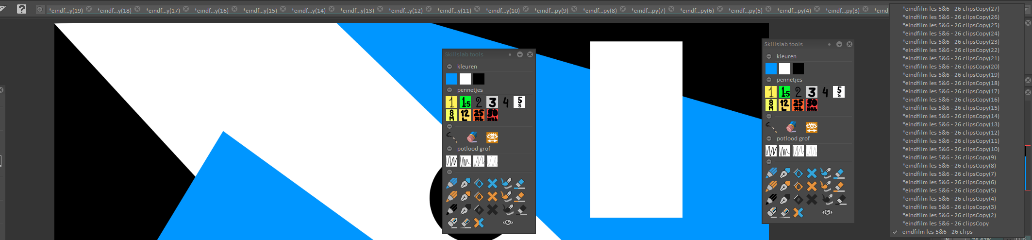

Oops i could not find where tvpaint saved the projects... and did it again only to then realize it just opens them as projects... now i have 50 projects openend
... how am i gonna save them without having to do them one by one?
edit.. well and then TVPaint crashed so i at least do not have to worry about how to close them all...

is there a way to save all opened projects easily?
Is there a way to close projects simply? i think i recall we used to have all openend projects visible as a list under windows.
this is not particularly pretty or handy.
neither is this: its silly looking...but this was addressed recently i believe?

Peter Wassink wrote: ↑07 Jun 2023, 13:56 is there a way to save all opened projects easily?
neither is this:
Unfortunately I don't think there is a way to save all the opened projects easily , all in one go. You have to click on each opened project and Save. One at a time ...
I wonder if someone (Svengali or Mads or Nathan) has come up with a script for Save All Opened Projects. This seems like it should be a new feature request. A "Save All Open Projects" in the menu should be built in. (or maybe in the TVPaint Converter ?)
